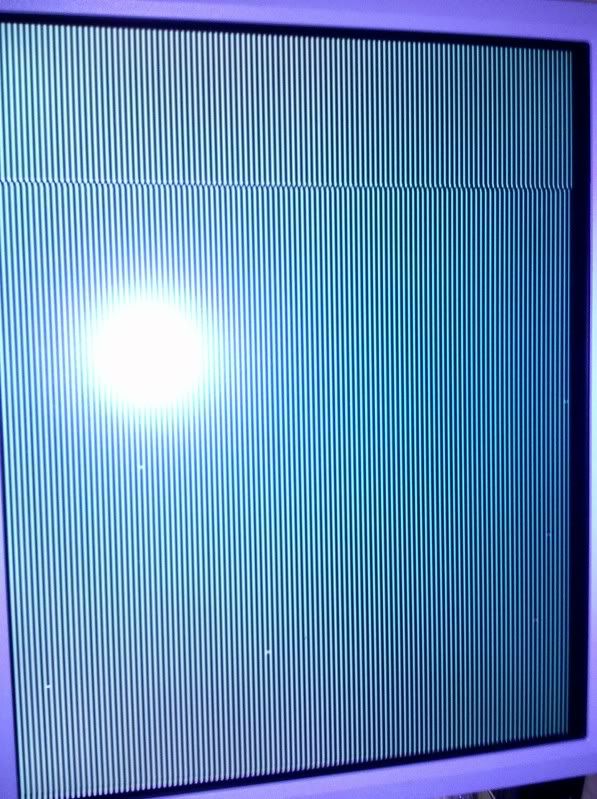

I just received a "working" Tutankham board from QuarterArcade.
(they've been awesome so I'm going to assume in good faith it works as stated when purchased.)
I am using the Tutankham specific Jamma adapter from Bob Roberts.
And I'm getting this rug pattern that varies between a few colors like purplish, greenish, redish, etc. and has a few dots that move around on the screen.
Anyone familiar with what this means? (I don't have any other Konami titles to reference nor do I own schematics yet).
--i should mention that this same cab setup works fine with a multi-board and a moon patrol board/irem-jamma connector. so I'm confident the cab setup is OK.
Any insight where to start? I'm hoping it's something simple like a voltage adjustment
--switching powersupply is putting out 5.1 volts at the pins on the Konami board.
--the -5 is running to the first pin on the board, parts side nearest ribbon cable
--the +5 is running to the farthest pin on the board, parts side-farthest from ribbon cable.
Thanks.

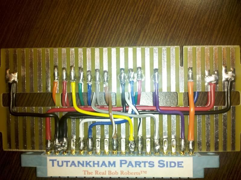

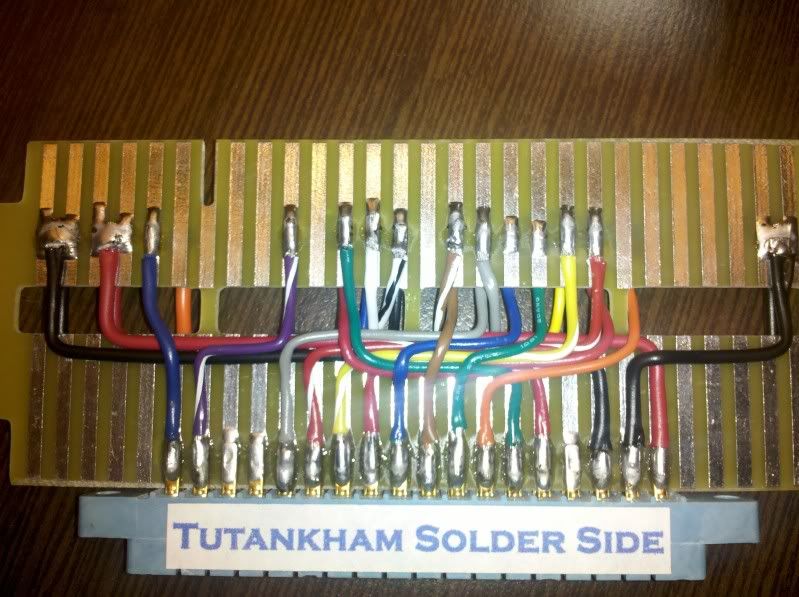

Also bear in mind that some of the Jamma connections may not be connected. Jamma has more pins than the Konami connector, so some are redundant. Perhaps a picture of the Bob Roberts adapter would help shed some light on what's going on. Can you put a detailed picture of it up?
hope this works. Sending from phone while riding in car.
Alright - the adapter looks good to me. So, assuming your Jamma harness is good, and you've got -5V, +5V, and +12V coming from your power supply to the proper places on the adapter, this shoud be good.

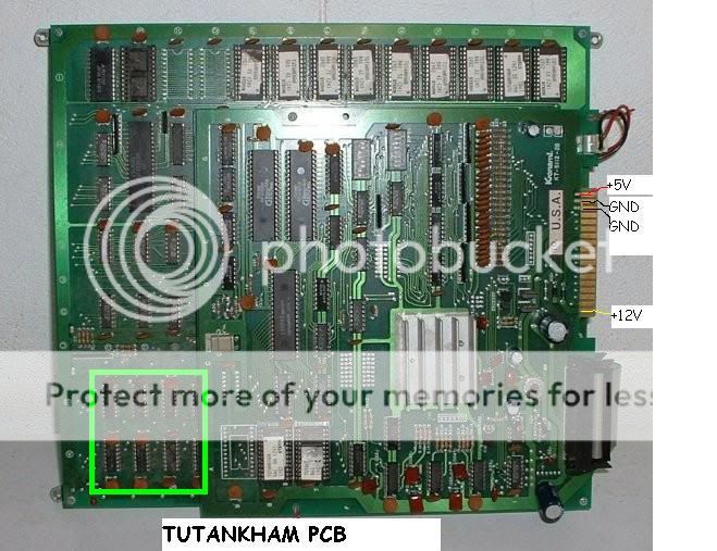

I still believe that this is a memory voltage issue, so...

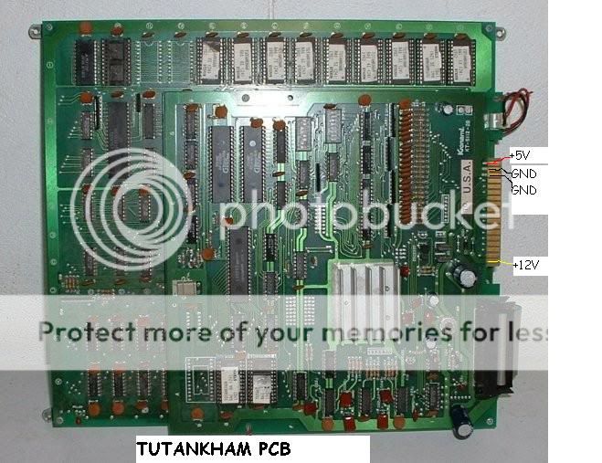

Take your multimeter and test the voltages on some of the 4116 RAM chips. Here is a pinout for those chips:
Put your black lead on pin 16 (Vss (GND)) and measure the voltage to pins 1, 8, and 9 on a few of those chips to see if they are getting the proper power.
And here is the location (inside the green box) of some of those chips:
One more thing to check -- hard to tell from the picture:
