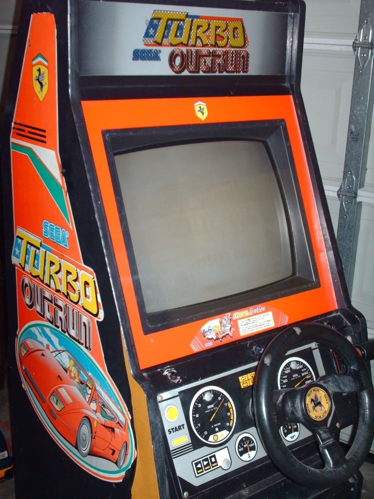

I was on the hunt for a Turbo Outrun for years and my wish came true about a week ago. I got it non-working but a few reseated cables and brought her back to life. I am very happy to have my old arcade favorite...I haven't been in front of a real one since I was twelve. Reproduction art isn't available, but I wouldn't have the budget for it even if it was around. My goal is to make this look better than when I got it, hence my title.
Here is what it looked like when I got it.
Here is what it looks like after I found some freely available art on the internet and 0.60 cents for red posterboard. Special thanks to JC Arcade for a good scan of the bezel emblem.
The steering wheel cap was printed on adhesive paper and stuck on a piece of plastic from an old folder, the map was printed on regular paper and sprayed with adhesive. The power cord was missing the ground plug, so I bought a new end and spliced it in.

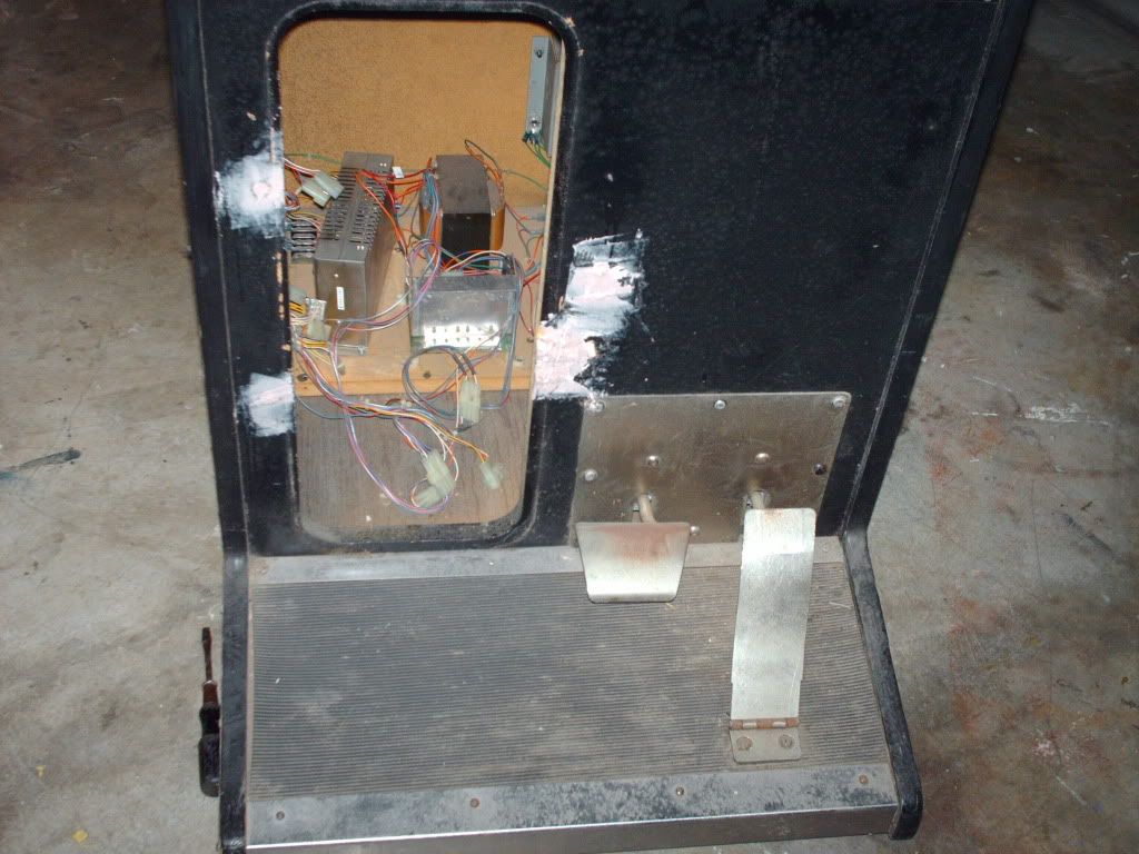

I removed the lock bar assembly and I plan to fill in the holes with bondo and repaint everything black.

I had a little time today and I removed the coin door to get better access to the lock bar holes and other damage the cab received during its former life on route. Next, I'll sand and paint.
Before:
After:
The other side, no art to worry about:

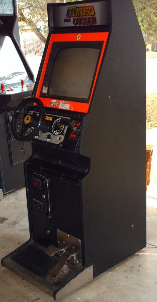

I had the entire day to myself, so I sunk the time into finishing off the cab's exterior. I sanded, masked, painted, and polished. The most surprising part of the whole project was how well I got the pedals to shine, and how well the rubber mat cleaned up. I also rebuilt the coin door and sprayed it with rustoleum textured black paint. It certainly looks like a much nicer machine now.
Side art side
No art side, the black monolith.
I give myself a strict limit of .50 cents in quarters so far and I have not finished the game. I may lower that to .25 cents after I finish it. I am well aware how a continue feature can ruin games, I have a similar limit on Toobin. I've got to earn my ending.
I still have some things to do with the machine, like wire up the coin door lights, hunt down a new steering wheel, rebuild the K7000, and stick some of the peeling side art back down.

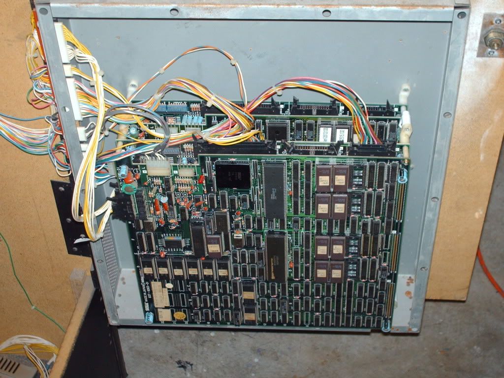

Per the DOA Outrun set, I was unable to bring it back to life, even after a new memory chip the self test flagged as bad. I still had a trick up my sleeve. One of the readers of this thread and I worked out a deal for a Turbo Outrun set with issues. When I got it, I set about converting it to a regular Out Run set. It was a tedious process, keeping each chip in the right spot, but it went without issue...until the first power up. I had a mostly working Outrun, but like Turbo Outrun, the glitches remained. After glancing everything over, I noticed some clipped components on this new set vs. my DOA set. The tally ended up being one missing cap on the upper board, two clipped out resistors on the bottom board, and two sets of jumper wires that needed to be moved into new slots. I ended up using the good top board that I fixed and the bottom board from my DOA set. After the second power up, everything looked just as it should! Whew! After other things in my life breaking lately, and my own spotty game PCB repairs, this is a huge win. I needed it.
It didn't help that my trusty iron broke it's tip while I was in the middle of repair. Nothing like trying to do tight work with a tip that resembled something bought at Rat Shack. My work station, and a complete set of working Turbo Outrun EPROMs and mask ROMS, and suicide CPU (still working). I thought about trying to sell what was left to recoup costs, but I'll keep it around for future troubleshooting.
