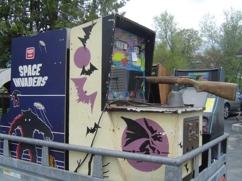

here is the best pic i could find of the day i picked it up. figured you might want it since your doing such a great job restoring it. Came from an arcade in Littleton NH.
good luck.
good luck.
Thanks! It's getting there and hopefully I'll be able to start painting this weekend, like I've said earlier I want to wrap up all the major cosmetic work now so I can fix the electronics and not have to take them out again later.
Any idea what issues it had? I've been told it was in the power supply, which I've now mostly rebuilt and the voltages seem good. When I plug it in I get an ambulance sound for a moment and flickering 0's on all the LEDs, I haven't hooked a monitor up yet to see what that shows. One way or another this SOB is going to work! :D
