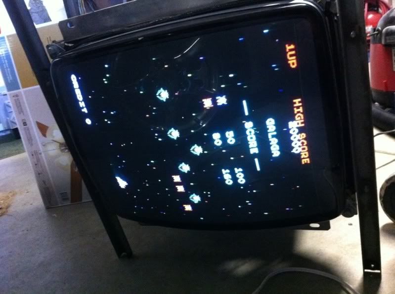

Just did my second tube swap today. It was a k7000 narrow neck cr 31 drop in the yoke was ok.
Andrew
I have the same monitor with a bad tube. What TV did you use??? Orion's charts seem to be for CR23 neck 19" tubes. I'm looking for a TV I don't need to swap the yoke on.
