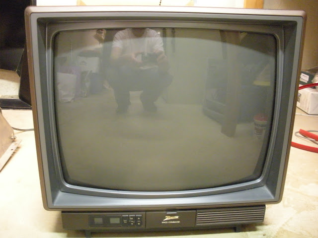

it gets easier once you know what your looking for. wood grain sides, 19", mfg date in the early 80's and there's a good chance it can work. i've found 3 of these tv's in my area which are a cr-23 socket everytime, yoke is a compatible with a wg4600. "zenith space command"
Thanks for the pic !
A reference page with pics of TVs with the right tubes would make things way easier , than picking one up off craigslist and not knowing till you open it up that it won't work .
The 20" TVs always fool me .
"space command" what the hell ?
