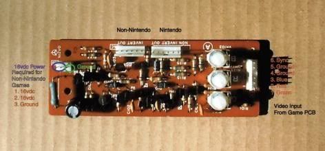

ok this is what i got a donkey kong monitor 20ez and the ribon cable needs to be wired for a new mikes arcade inverter board for the video out since the plugs arnt right.heres some pics to try to explain.what i really need is to know where i guess number 1 would be on the monitor board so i can wire the colored wires to the ribbon cable .so is like the very top of the plug 1 i dont know.thanks bob

Your jamma harness is gonna be wired into the input on the inverter board, then the inverter board will go from inverted out to the chassis.
I will find the wire diagram, one sec.
Pin 1 - green
Pin 2 - red
Pin 3 - blue
Pin 4&5 - ground
Pin 6 - sync
Pic below for wire connector reference.
