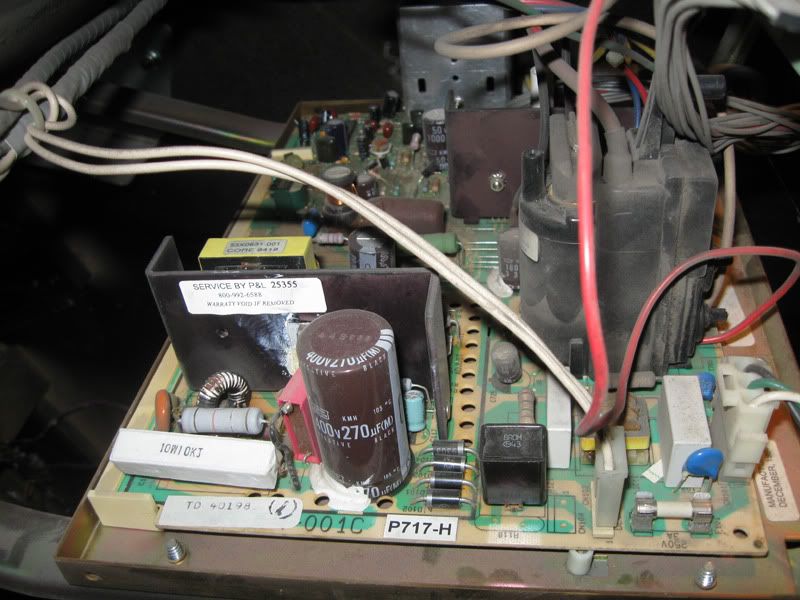

Sorry to bump this older thread but can someone confirm this is a K7400 variant? Also, it has a 2nd set of pins identical to the input connector... do these chassis do dual-res?
EDIT: Actually ... I think that there be a U2000?
it is one of the variants, but hard to tell which from the angle of the pic. Looks like the horizontal width coil is by the HOT, which would mean a standard-res U2000.
The dual-res U5000 would have two sets of headers in the center back with a connector to move between them...
There is a 5-pin molex connector next to the copper coil looking thing (not the width coil) in the picture to the left... middle of the board...behind the large brown component (resister?)
That is it.
P717 is a U2000 chassis. Other than that, I'd need to see better pics to determine what you are talking about. Some of the variants have a molex connector behind the remote cable connector for the purpose of installing a pincushion board, but it has more than 5 pins...
