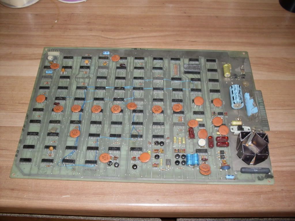

After looking at the wiring diagram, it appears it comes in as AC, and then is converted to DC on the board? Is there anyway I can make a JAMMA adapter with DC voltages that will run the board, or connect DC after the conversion points?
Also, is the video output for a TV-type monitor like Computer Space was, or is it for a regular B&W monitor like Space Invaders used?
Obviously I have no gun to test it with, but I'd like to be able to see if the board works...

This the duck shooting qwak or the ducks floating through the maze qwak?
Not trying to be a smart ass, but I'd say the former..
Well, I guess I don't know for sure. I wasn't aware there was more than one. Can you tell from this board pic?
BTW - obviously I have to replace a missing cap there on the right...
shooting... ducks in the maze is a 6502 game
Okay. Any insight on a way to test this - besides finding someone with one? I can rig up a connector, but not sure what types of voltages I'd need, nor whether I can hook it up to my SI monitor easily enough.
I just want to see video and hear sound. Figure someone might be interested in owning it besides me, and I'd like to see if it works or not before I sell it...
Well... if you have the pinout and it wants AC, find a transformer (or variac) and give it what it wants. Or, you can probably just jumper whatever voltage(s) it needs right to test points (or cap legs, or whatever else you can get jumper wires attached to).
