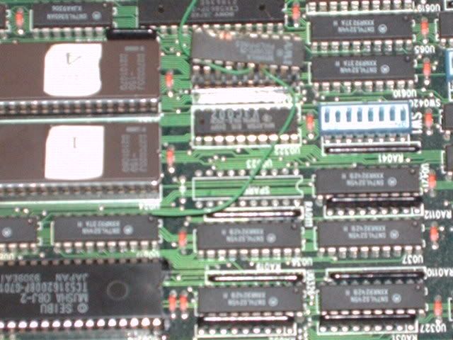

I have had a request to post the information as to how I initialized the board to fix the sprite corruption after the Dead Battery Society EPROMS are installed if you have a board with this odd piggy back PAL configuration.
VAPS lists only ten of these boards and a lot of these are in unknown condition or not working. If this information gets more of these boards in circulation I will be very happy. Please post here if this helps save a board! This information has also been e-mailed to Tim at Dead Battery Society. One member is going to test it on his boards to confirm it works.
The first thing I did when I got my board was to remove the battery. I never powered it up until I installed the suicide fix EPROMS. At this point, I left the piggybacked PALS and all jumper wire alone. It booted, but all sprites were corrupt, just like a board that had suicided. The background layers were okay. I tried a couple of things. I removed the piggy back chips and installed a socket on the motherboard for the bottom PAL, and then installed a socket on the top of that bottom PAL so I could test the two independently. It would not run with the bottom PAL independently at first. At this point I was out of ideas and tried this bit of soldering.
The top PAL is an AMI branded chip at board location U0310 markings
9250MEA
18CV8PC-25
You will be using the wire running on PIN 17 on this 20 PIN chip. It should have several green jumper wires all ready. Note the point on the board where it is connected. Desolder it from the board and run it to PIN 57 on the surface mount chip at board location U096 marked
SIE15O
WA30601
See the brownish pad in the picture. Pins are clearly marked on the board's mask and this is a 100 PIN chip.
Power up the board and you should hear some sort of chime audio string along with a screen of mostly junk graphics. I did this several times sometimes the entire chime would play, sometimes it would get cut out. Only one time should be required. After this, you should be free to desolder the top piggy back chip and all of the jumper wire from the pads on the board. Keep the bottom one where it is or the game will not run. Graphics should now be okay.
No guarantees this will work, it was a shot in the dark on my part that just happened to work. Be sure to install the four Dead Battery Society EPROMS.
Also of note: This board seems a bit sensitive to sync. Don't forget to dial it in correctly. I am using it with a rebuilt G07. This board is also part of the UnMamed set of games at the time of this writing.

I am happy to report that ifkz's fix worked on both of my dead Zero Team boards.
There is one step that he failed to remember in his earlier post (he had done it, just forgotten to put it in the step by step) and that is to repair the cut trace on the bottom of the board. The attached picture shows where to make the repair, the trace runs between the two yellow circles. For refrence, I have marked where the cut was on both of my boards with a red circle.
I left the wire from pin 17 on the PAL floating and just touched it to the pin 57 solder pad a couple of times while the board was running. I didn't hear any chime or notice any difference while the board was running, but when I powered down and removed the other two wires the boards came back up in perfect working order.

Both of my boards had the trace cut in virtually the exact same spot. The solder pad I connected to at the top of my picture is the one that the green wire from pin 16 on the PAL connected to on the other side of the board. That combined with the fact that it was done on both boards led me to believe that it was performed as part of adding the second PAL to the board.

I am wondering if your board also has a cut trace on the back, so far every board with this PAL configuration I've heard about has had it. Be sure to fix that too.
Cool, another one saved. Please add it to your VAPS. Edit: saw you had already.
Yep, fixing the broken trace underneath the pcb was the first thing I did. I desoldered the jumper from U082 and soldered that to pin 57 of SIEI50 located at U096. Then I replaced the 4 eproms provided by DBS and Hobbyroms. After that I powered the board for the first time and graphics were upside down and garbled, but I heard the "chime" you mentioned in your earlier post. I powered off the board and removed all the jumpers and the piggybacked PAL. Powered the board one last time and what do you know it's back to normal again. I played through the whole game to make sure and its def 100% working. :)
Mine was exactly like yours. Piggybacked PAL, jumpers, and a cut trace on the solder side of the board. I believe this is only on the USA region pcbs.
