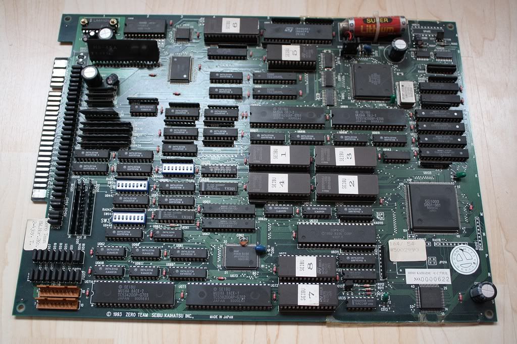

I ended up with two rare Zero Team PCBs from KLOV members here. One is completely stripped of all parts that could be removed: amp screws and EPROMS. A bunch of caps have been ripped out and one three legged transistor is gone. It's pretty bad off.
Before I got that one, I had already ordered a somewhat responsive one from a for sale thread here. I got that today and I was able to compare. It is a little better off, but badly warped and mostly complete. Two resistors are gone. Any tips on straightening it out?
I just looked through my parts boards and I have enough components to fix them up, save for 4 2MBit EPROMS. Good thing I have a Raiden II parts board. Later I'll have a friend burn some resurrection chips and hopefully I'll end up with two working boardsets, one as a spare. Maybe I'll run into some more EPROMS by then!

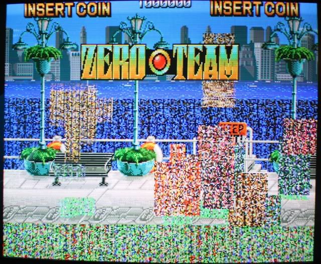

Okay, I got the fixed EPROMS from the dead battery society page, put them in, and I am greeted by a good background later and scrambled sprites. Colors are correct now, which is better than went I started and I didn't have a background layer before. Progress?

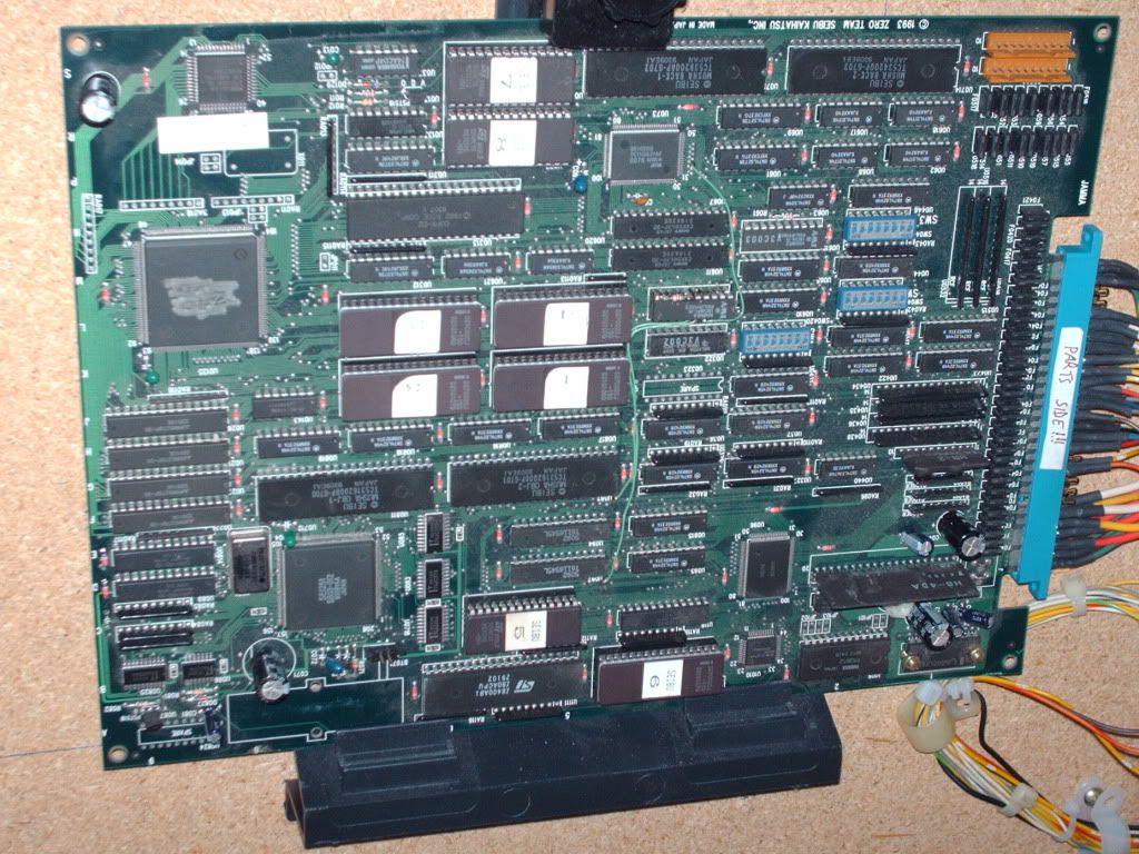

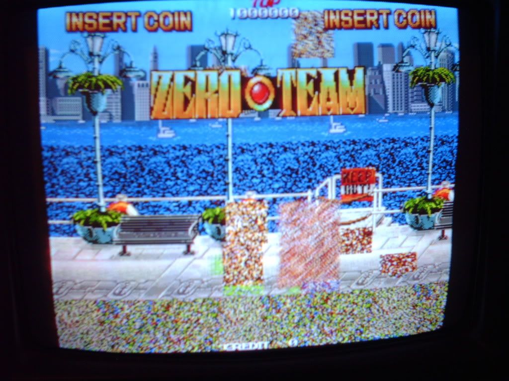

I did a bunch more work today on the PCB, I replaced sockets on a wierd chip hack that Seibu did on this version of the PCB. I also found a very tiny cut trace on the solder side of the PCB. I can play the game, but it is more like Double Dragon the Block Returns! I've noticed a few things, and I need a high res scan of a different board version. You'll see
My board with the suicide fix EPROMS installed
The other guy's board.
Notice the lack of Seibu's early hack that is on mine and also my parts board. I have tried removing the hack per the Dead Battery Society's instructions. I have tried removing the three strands of the jumper wire. I have tried removing one chip, but not the other. I am completely stumped as to why my sprites are still screwed up, they look exactly like a suicided board.
Mine.
The other guy's screen before the suicide fix EPROMS.
They are identical!!! Argh!!! I know it must have something to do with this line in the directions: "Some PCBs use an extra PLD (PAL or GAL) mounted on a PLD which can be removed for the battery-less program. Thanks Afzal!"

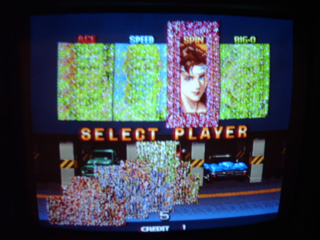

Looking over the PCB, I saw a spot of previous solder work on one pad (some of the rosin left over from soldering was visible. For lack of any other leads, I soldered a piece of jumper wire to it and began to un-hook the other pieces of wire from the top piggy backed chip. On the last wire I heard a chime and got a pretty corrupted screen of characters. On a reboot, I found that some of the sprites were now drawn correctly. This proves my theory that something on the board is saving some type of data from the whatever nasty security program Seibu came up with. Now I no longer need the chip that was on the piggy back and some sprites are permanetly okay. Now I need some member to show me how to re-initialize it completely.
The bikes are now present.
One of the main characters has most animations drawn correctly (the one in the pink thong), and some background elements are present, like the crowd. Later levels have boats, airplanes, etc.
Can anyone help my bypass the last bit of the security on this board?

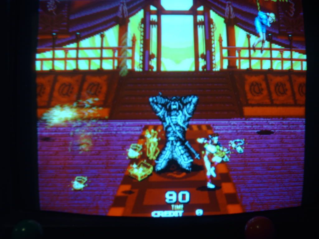

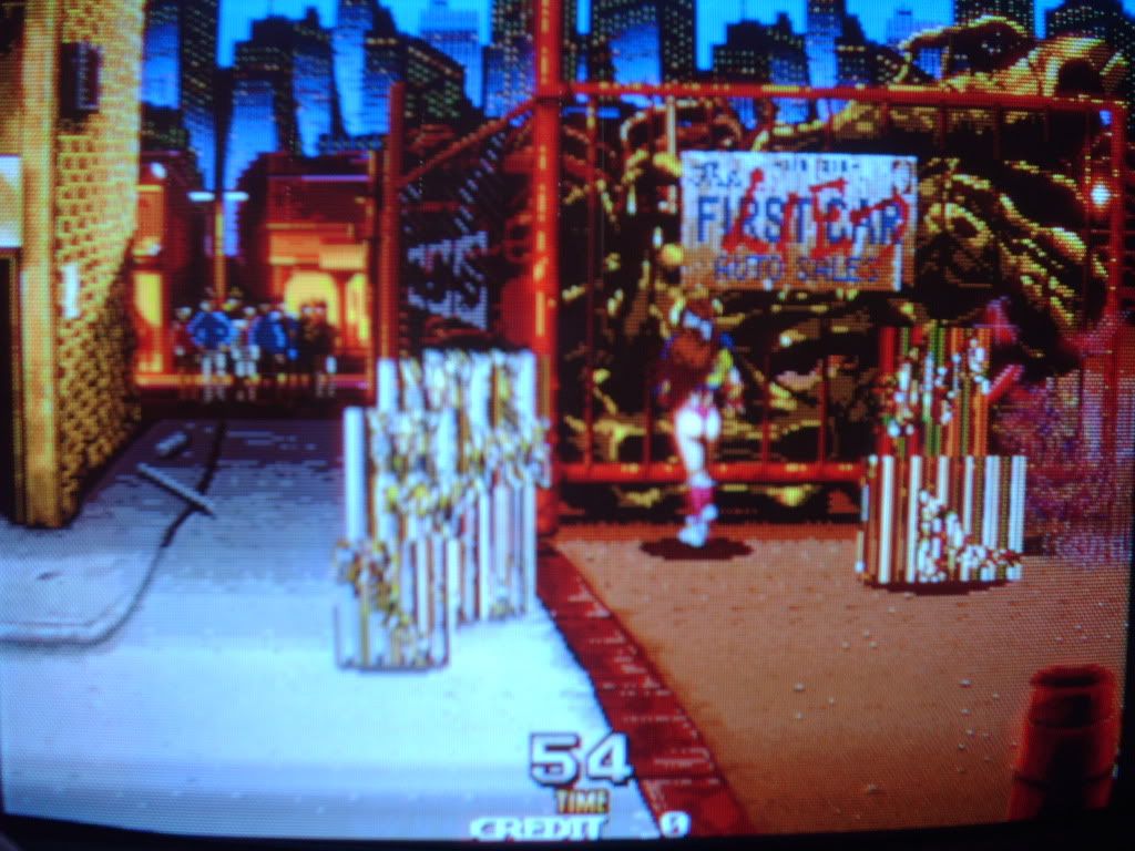

I went to play this partially repaired PCB tonight while the forum was down. The graphics started glitching out and I tapped around the board as I had done several times before. I found the graphics changed to a 100% clean screen when I applied pressure one of the main customs. That was something new!
This chip is the one with hair thin spaces between the legs, no room for error! I had been over this chip several times before and I gave it another shot tonight. Afterwards all I could think was...there is a Santa Claus!
I can now see how much care Seibu put into this game. When struck, enemies drop their weapons. When thrown, enemies react to walls by slamming up against them.
There are a lot of detail oriented little touches. Rats running around on the first stage for example. Innocent bystanders spot you and run away in fear.
It is a quirky beat-em up, often times poking fun at the genre. One of the special items you pick up is toilet paper, for example.

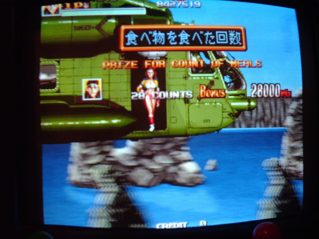

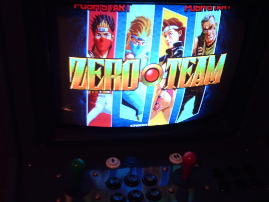

Some pictures.
Splash screen all cleared up!
Character select screen all fixed!
Final boss
Bonus screen after the game is finished
