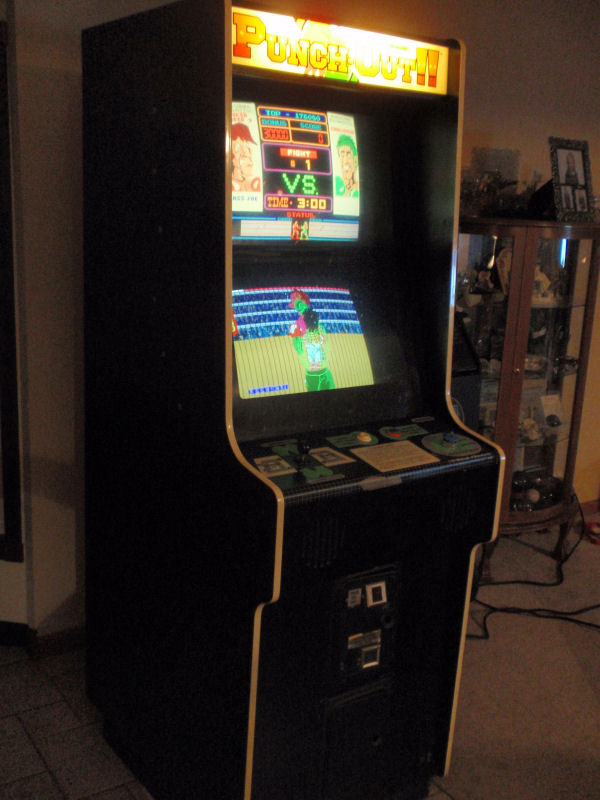

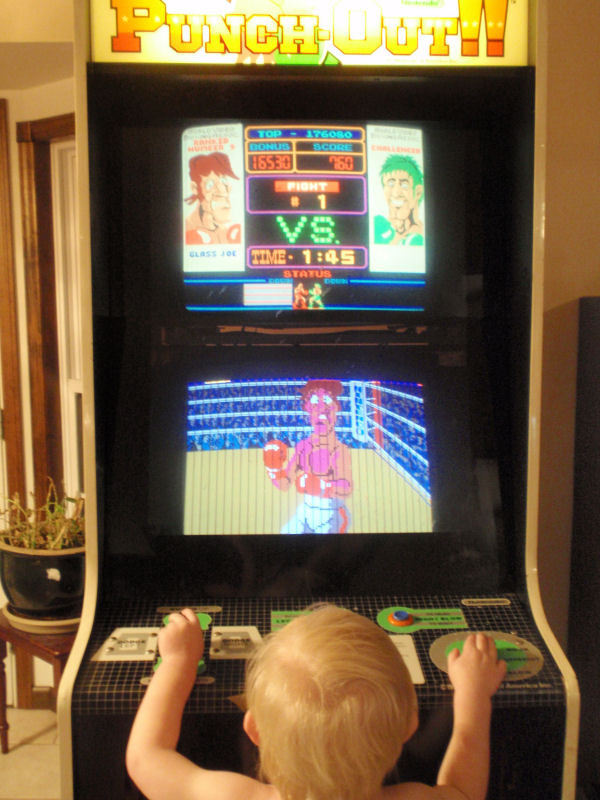

Anyways, this Punchout works but needs some TLC. The bottom monitor needs a cap kit (1/2 inch of video smashed at top) and the PCB has a video memory issue. The black bars move (so its not the monitor) and Glass Joe has a nice purple rash. I suspect video memory, but the 8416's are soldered on board (manual says they are 6116's different manufacturer, same memory), so it will make it more difficult. Reseating all other chips didn't help.
Of course it could always use repro sideart and CPO, but one thing at a time. As you can see the little guy was digging the game. I will post about the black bars/video memory issue in the repair section.
