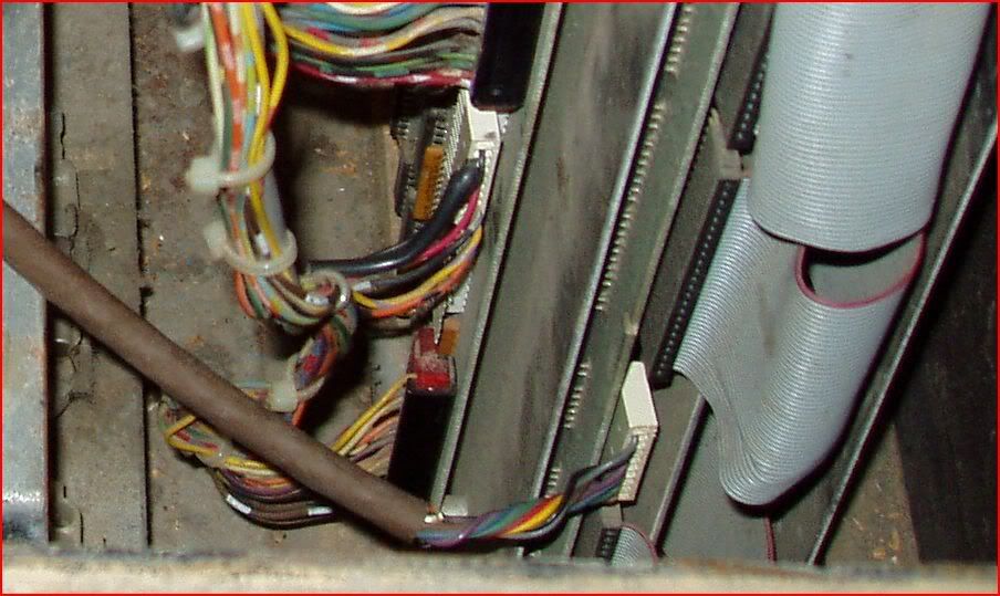

just bought a tron machine was in good conditon except one thing ..... when i turn it on i get a blank white screen ??? someone help me out here
Check all voltages, turn the volume up and make sure the game isn't playing in the back ground (coin it up and listen for the music). While you're at it, make sure the brightness on your monitor isn't turned all the way up.
EDIT: Also reseat all the chips, make sure the board interconnect cables are snug and if all else fails run the built in tests on the boards.
First, turn down your brightness until you can barely see a glow.
Next, check to make sure this brown wire and white connector is connected here on your boards, and the other end is connected to the monitor....
my tron machine
k i turn it on i get that screen pictured there and as audio wise all i hear is a hum the cords where connected

ok how do i check the voltage and if there to much or too less what needs to be replace . thanks
Grab a multimeter and the PS or game board schematics and test the points for +5, -5 and +12 volts. If any of those values are drastically different, youve found your problem.
