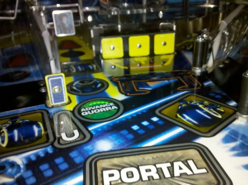

I am seeing some dimples on my Tron LE. Nothing like your pics.

Can you post some pictures with a reflection? Anyone else on here that can post pictures, there has to be like 30 of you that bought Tron: LE :)

Ah, sorry. I don't have any overhead lights so I'm not sure the pics will show any reflection. The flash from the camera may not show any dimples. I'll try anyway.
Any light source would work that is bright enough. Have a shop light? That would work too.
hope those help. i snapped 'em real quick with my phone.
oh, and i have 309 plays as of this morning.
Thanks for the photos. I tried this same angle on my game and the dimples/indentations aren't really visible in the photo. You probably need to be above it and get some reflection from a ceiling light to show the surface in that Recognizer area.
That is some SERIOUS "fish eye- ing". It is caused when the clearcoat is not the proper viscosity, and applied incorectly.

Fisheye is caused by oils on the surface when applying the clear coat. It would be visible when the clear was shot, not just after 190 games.

I would also take the ball and drop it in that area. If it dimples, then of course you know it's the wood. There's no way clear coat alone would stop dimples, its the soft wood under it that let this happen. A cars clear coat is paper thin, no way in Sterns cost cutting would a pin have a lot more then a car.

Stern playfields ALWAYS dimple (but not like the OP pics). Look at a LOTR, TSPP, SM, some of the more played titles - the wood they use is "cheaper". Even the cabinet wood is flimsy - i've drilled for 4 or 5 Shakers and am lucky to get away with 3 of the 4 holes surviving / not flaking apart.

As for the playfield posted here, something is wrong / abnormal with it. As noted on RGP, i took pics / closer look at mine (bad pictures though - sorry) - and no dimples / holes after 100 plays. I would be VERY surprised if Stern didnt back up that PF after an analysis is performed.
