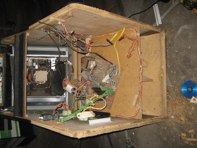

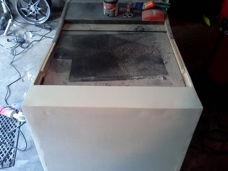

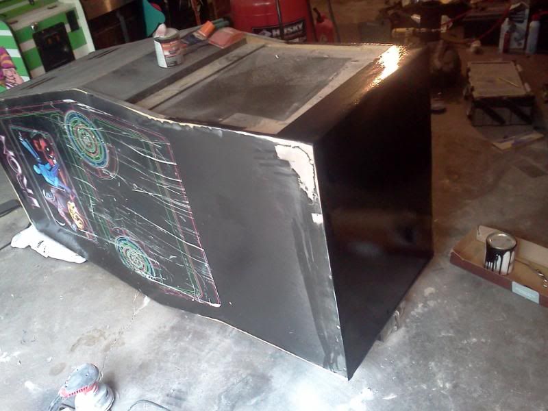

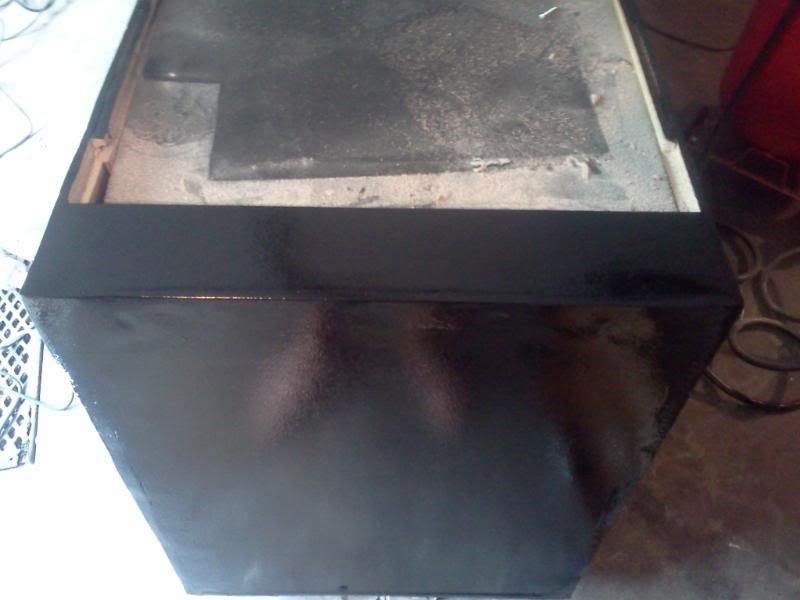

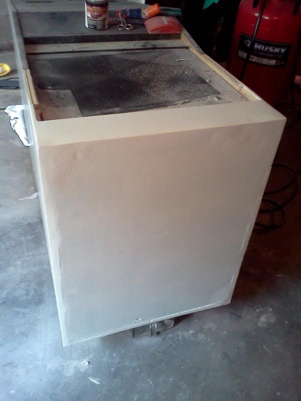

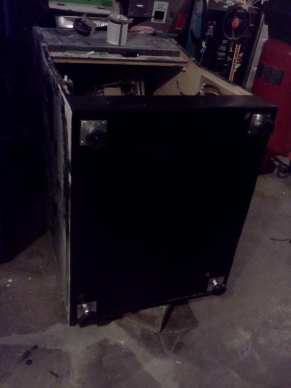

Welll I finally got around to doing some work on my Tron. The bottom was literately falling apart and I was sacred to move it since it worked fine. There was also slight water damage. I completely removed the base and cut about 3/4 inch off all the way around the bottom to get rid of the slight swelling. I did not really spend much time on the base because it will not really be seen but I made sure it was sturdy as hell. I also didnt go how it was originally, the pics shows what I done. I will be adding leg levelers soon and standing it up and begin work on the sides. I am not going for total perfection. I am going to just make this game nice and presentable because when I got it , it was beat to shit. Also the paint in the last pics is not dry yet, I am doing satin black, and it looks gloss because its still wet

Looks good so far. I have a Ms Pac that also has horrible damage to the bottom panel and I have to replace it. What sucks is it's hard to use the original dado cuts even if you can remove the old panel without damaging them. Did you add any kind of bondo or putty to any gaps between the new bottom and side panels? It kinda looks like you might have and that's what I'm looking at doing because of the missing wood on the bottom of my side panels.
Yes I did add bondo to all the cracks, look like crap on the bottom because I rushed it but like i said before its the bottom so no one will see it, I was mainly fixing the bottom so it would be sturdy and hold up again. Next weekend Ill be doing the sides and adding new side art. The sides will be fairly easy since it doesnt have any major damage
It's definitely a pain to try and work with the original dado cuts if you're just replacing the bottom. There's really no way to slide in a new rabbet cut piece into the dado grooves unless you try to maybe knock the lower back panel off then I guess it could slide in. For me, the collateral damage in removing the bottom made it pretty much a given I wouldn't be able to use their dado cuts.
