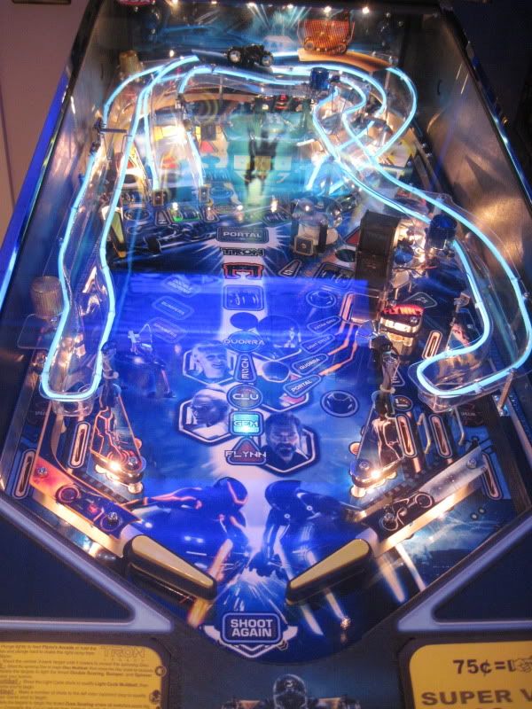

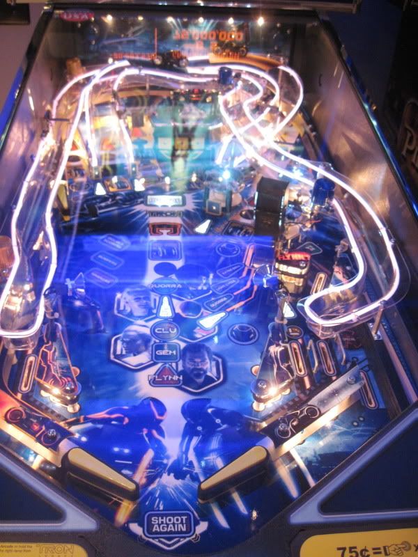

You know what would peak a lot of interest...figuring out an EL wire add-on for non-LE Tron pinball owners. Just a random thought.

Here's what I use the glowire on. :D
