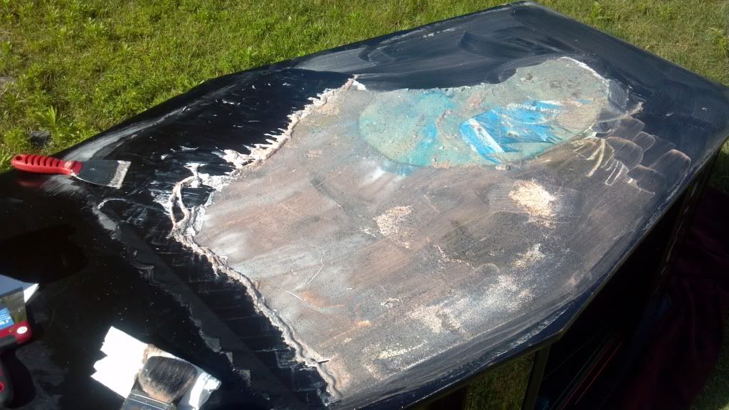

Hey everyone,

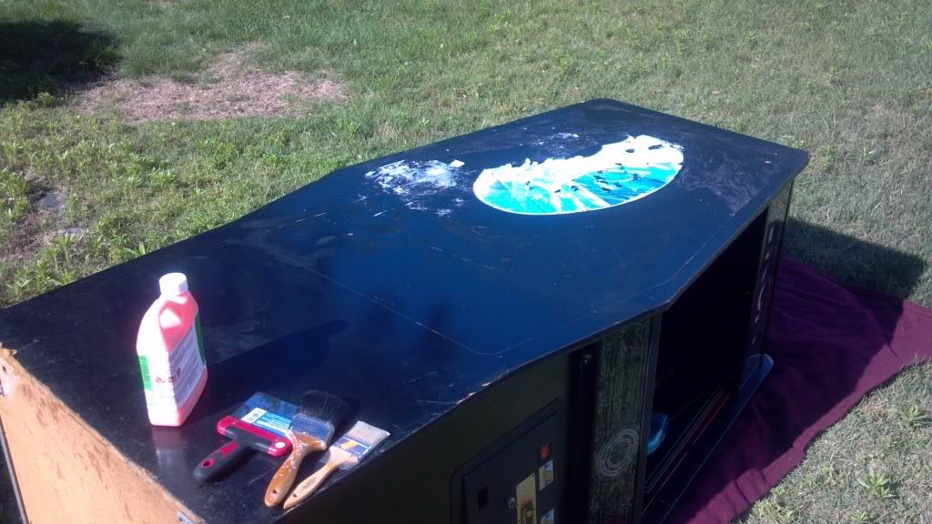

So I bought a Tron on the cheap that was converted to another game (Time Pilot 84'), and I'm looking to restore it to respectable condition. I need some advise on what to do with one side of the cab (or both). The sides were painted black. After giving up on using a heat gun, I used Citristrip, a putty knife and some patience and removed the paint and side art without much difficulty. One side of the cab came out pretty good imo, I feel there's no need to do anything but put new side art on it.

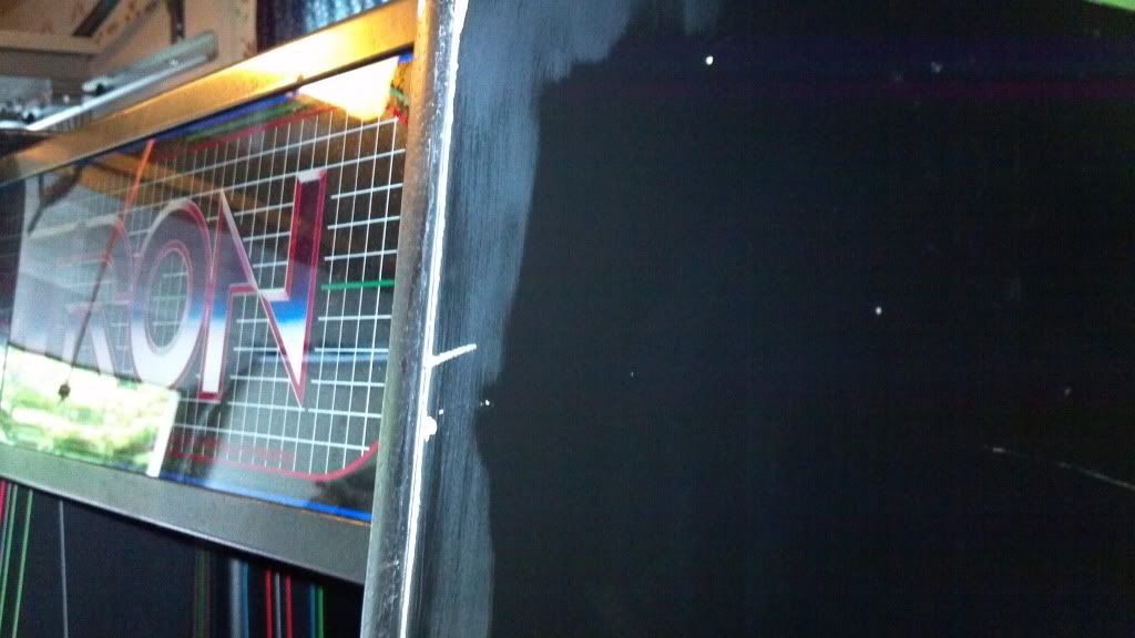

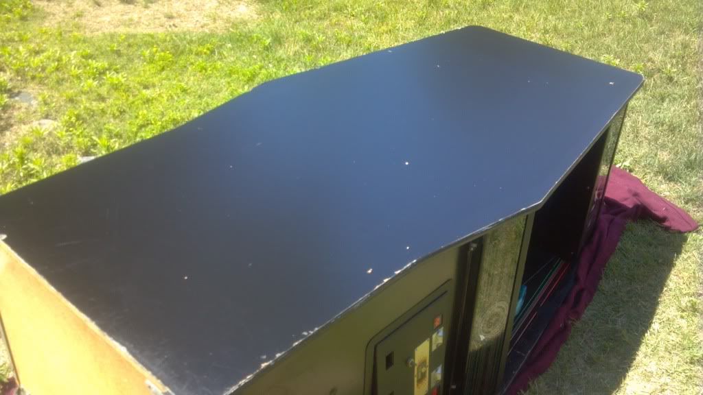

The problem is the other side that has what seems to be sandpaper/sanding damage to the melamine towards the front and rear of the cab that surrounds the artwork that I'd be applying there. Just a few areas, not too widespread, but enough for me to see I need to address this.

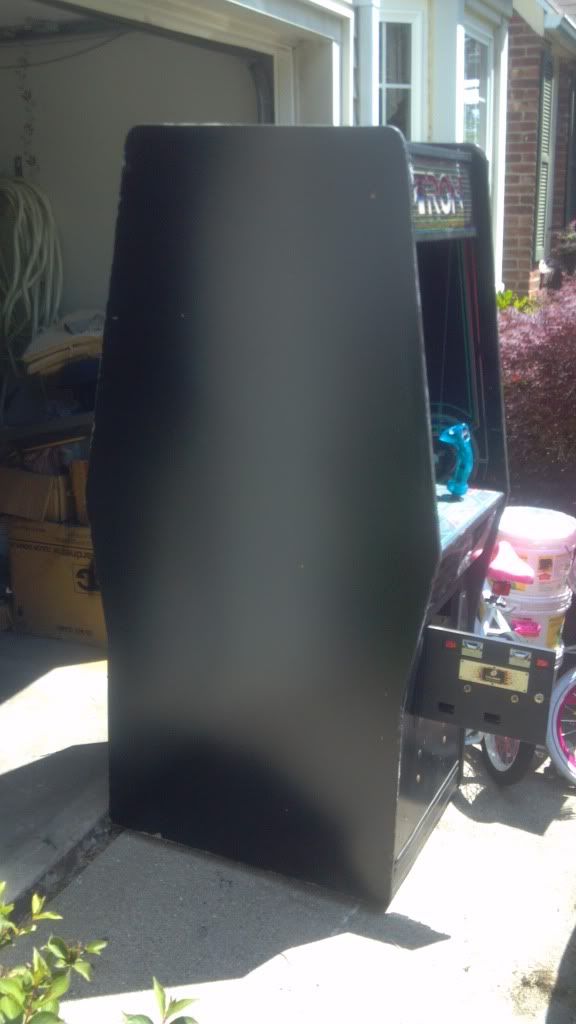

The rest of the side looks good and I wouldn't touch it, but due to these few sanded spots, it appears as though I'm faced with spray painting (priming then painting with satin black, then finishing it with a satin clear) on that side. I'm sort of hoping I don't need to go through all that, but I will if necessary. I'm guessing it would be the best thing to do at this point, but figured I'd ask anyway. Would you think I can get away with just spraying a clear satin on that entire side to help blend or cover the sanded damaged areas? Thanks for the advise.
Ted
You picked up your cab on the cheap, but there is nothing cheap about a Tron restore. If you are going to pay for new sideart, I would not put it on that cab without a complete repaint. The art is too nice and too expensive to not do it right. Strip it down and repaint the whole cab is my recommendation.
Agreed. Though the one side does look decent, those dings in the melamine need to be addressed. After they're bondoed and sanded, you'll need to paint. And if you aren't happy with the sheen of the paint when you're done, let it cure a few days and apply black vinyl before applying the side art.

1. Don't ever vinyl a Tron. It's not even remotely accurate, and a waste of Tron art.
2. If I has to do it over again, I would spray paint it. If I had access to an HVLP Spray gun, I'd do that. Otherwise, I think that if you take your time and do light coats with rattle can satin black, it will come out fine.
Your cab is in decent shape, so it wouldn't take much to fix up the few dings and do it right. You'll never kick yourself for doing a quality job, but you will if you do a half-ass one.
Before my guy bailed on me he brought a formica sample over. It was vertical grade (thinner) but it still was a bit too thick - it would have stuck out past the t-molding unless the sides had been sanded down further. Plus it had an 'orange peel' texture, so it was not smooth like melamine.
Just tonight I picked up a decent CFM compressor which should do nicely with a hvlp setup for this job. I figured on trying oil-based satin black at first and see how that comes out, possibly trying an enamel satin if I'm not satisfied. Now I just need to repair the bottom of the cab....
