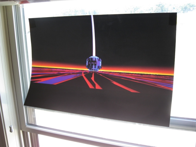

The back lit MCP film from a TRON cab. Best way to clean it? Also, when you reinstall the original or install a new repro, do you reinstall the staples? Or leave them out? I removed mine to clean and it is filthy. I just don't wanna wreck the surface or scratch it. I also don't wanna risk tearing it when I reinstall it.

I tried some light wiping with windex on a paper towel...and ended up with an orange/purple/blue-ish colored paper towel, meaning I was removing color.
I stopped right away and the translight still looks fine, but the idea of compressed air or another dry method is definitely best. Or, if that's not enough, maybe just a very light wipe down with a dry towel...or just water or something weaker than windex.

I did mine with a slightly soapy, wet cloth. Worked fine. Just be very careful with it. It certainly is fragile. I don't recall for sure how I reinstalled it. Probably with staples.
Well I tried glass cleaner first, then quickly changed to a spray bottle of water. It looks a hundred times better, but now I have a few water spots that formed toward the bottom after the water evaporated. Don't wanna scrub too hard, so I'll just leave them. Still wondering on the staple thing. Is it worth reinstalling them? What do they really do, hold it tight to the shroud window??

i stopped using paper towels and starting using the microfiber towels. They don't leave any little fibers like paper towels do and in the long term are cheaper. I would just take it out and use a really soaking wet microfiber towel, seems like the more water you use the less scrubbing and less scratching there will be.Once its clean blot it dry with another towel.
That's what I did. I learned a long time ago that paper towels are good for leaving severe lint trails and scratches behind. I held it up to the window and it looked glorious. What a great graphic. The illusion of space is immense.

Someone was trying to work on the DOT. Fortunately, mine are both pretty good. I've used all of the suggestions mentioned on both of mine. Compressed air will do nothing, Windex and water will both remove slight amounts of ink and streak it. However, the streaks are only visible outside of the game. The key is to wipe it with a water dampened microfiber or paper towel and overlap your strokes, like painting. This will minimize the streaking. If it's too bad, just go over it again with just a little water. I also used compressed air to help dry it more quickly. They are scary to remove...especially DOT. I used Scotch tape to reinforce my holes before re-installing. I also had a very small white spot on my DOT that I tried coloring in with various markers. It's a little noticeable if you're looking for it, but otherwise you can't see it.
