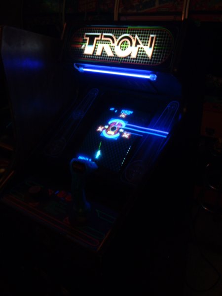

Not a dedicated cabaret, but I also felt the need to black light once I got this little guy...
I used the cold cathode tubes folks use to customize their PCs... there are more pictures here...
http://www.vidiotarcade.com/TronCabaret-Cathodes/

I did it! Enjoy!

I used UV LED lights commonly used for lighting computer casings, like glowing neon lights. I specifically used ones that were grouped together in a flexible silicone bar. This way I could flex the whole bar & not destroy the wiring.
As far as installing it into the joystick, that was a challenge. I had no idea if it was going to work. I had only heard of others saying that it would be cool if it could be done; so I took a gamble, bought a bunch of parts & tried. It's tight inside the joystick & even the LED's would only fit a certain way, so the stick dictates how much you can really put in. I was able to get in 3 bars of 6 LEDs each in to the stick. You biggest challenge will be pulling the wiring through the joystick metal shaft & spring protector under the joystick. It's super tight & I believe it will only take 22 gauge wire, I tried 18 gauge, but even that was too thick. You'll have to tie all the wires in the handle together before pulling through the shaft. Just no room in the shaft wire opening hole. & some parts of the stick are solid, like the metal shaft, so that part won't light.
Sorry I don't have picks of the install. I was just happy to "trial & error" it to work at all. It didn't take too long to get the whole thing finished & I am very pleased with the result. I only wish I could diffuse the lighting a bit more through out the stick.
