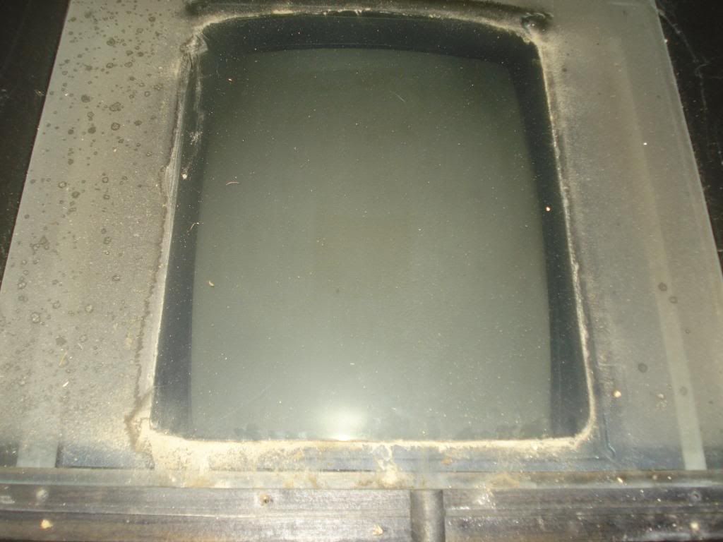

Trying to remove the bezel from my Tron. - Need to clean monitor glass.
I have already removed the FOUR screws from the bottom of the bezel and the four
that sit BEHIND the marquee.
Bezel "seems" loose, but it wont come out
Were these originally also "glued" in?
I'm stuck.
Any tips greatly appreciated.
Thx much
Rob

Rob - doing this from memory so excuse me if i send you down the wrong path - is the shroud in place (the big plastic shroud? This thing needs to come out first as i recall - 4 screws ABOVE, underneath the marquee - that unit just slides out and *i think* provides access to the bezel glass (the glass is on a down angle right?)
Jon - yes the "shroud" is in place
that is what I am trying to remove
Service manual refers the the shroud as "the windshield"
I have removed 8 screws - still wont slide out
No - control panel is still on
does that need to be removed before the "windshield" ?
You might want to remove the control panel since your going to need to remove it anyway when you take out the glass. I am not sure if control panel also locks in the Windshield Bezell but it might give you a better look.
ok - shroud / windshield / spit shield / whatever.....
As i recall - 3 screws on the metal plate (lifts off). Then, 4 screws on the spit shield lower. 4 on the top... As suggested, CP off. Slide it out... no glue should be holding it in - check for a "lip" or something hooking on the top?
I recall on mine it was tight / stuck, a little finesse may do it....
Finally got the windshield out
Had to pry it out with a flathead screwdriver
Had to pop the bottom "lip" on the bottom at both the left and right sides to get it to come out
Tight as a damn drum......
Thanks for all the tips and info
Rob
