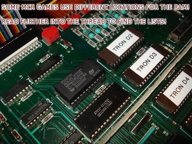

Instead of a battery you could just replace the RAM on the center board with an NVRAM, then you won't have to worry about batteries again for about 10 years. Plus the boards can be disconnected from the PS without losing scores for if you ever have to work on them... hell, you can remove that RAM, put it on a shelf out of the board for a few years, put it back in and your scores will still be there. lol Love 'em. Here's the picture of one installed on my boards. Works like a champ, it's a little sensitive sometimes, but that's because of the power at the arcade being a little wonky in the morning when you first hit the breakers. At home, I had 0 problems with it.

The replacement rams are pretty cheap, I was selling these for something like $12, but people were having trouble getting them to work... even though I tested every one of them on my personal Tron machine with no issues. I would've kept selling them, but the "tech support" was just killing me.
