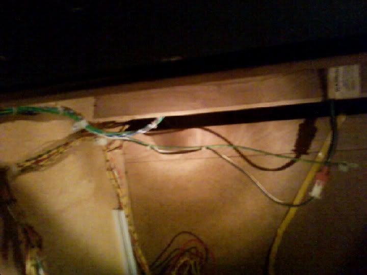

However, step 4 seems a little vague and without the picture it seems pretty difficult to figure out. What are the A.C. L and A.C. N terminals and which wires are they referring to when it comes to cables feeding the monitor?
Also, I discovered one problem that may be the cause of everything ever. One of the cables is disconnected that goes to the big block at the bottom of the cabinet. It is black and yellow cable and attached to it is a green cable that came loose. I don't know where this green wires goes to. Anybody have any ideas? I have a few pictures posted below.
The green wire is your ground wire that clips onto the side of the monitor frame.
AC L (Live?) AC N (Neutral?) would be my guess, but it's best to ask Steven or maybe someone else has installed this kit on their Tron. Mine's all original hardware.
Hmmm, side of the monitor frame? Is there anything in particular that I should be looking for?
Also, who is Steven?
I pulled Tron out to take a couple shots for you that may replace a thousand words. I apologize, I was under the impression you bought this kit from arcadeshop.com, and Steven Gregory is the owner.

Ahhh, I did buy it from him. I will go ahead and ask.
I see. So that wire straight up attaches to just the metal frame. Strange. Oh well, thanks!
Check the Yellow ground to the CP
Had the same problem! If the ground to the CP is not hooked up on your Tron it will not work right! No sound no picture! Check the ground! Try that. It goes right up to the optic board! Move it while the game is on. The CP has 2 latches and opens right up! Good luck
Just installed this power supply kit. The two wires that (should) be coming from the isolation transformer to the monitor power connector need to be tapped. Tap each wire below the monitor power connection point. When you install the taps be sure to compress each tap so it makes contact with the wire supplying the 110V A/C and the wire going to the power supply. In the pictures you posted you tap the white and black wires that terminate in the white connector.
