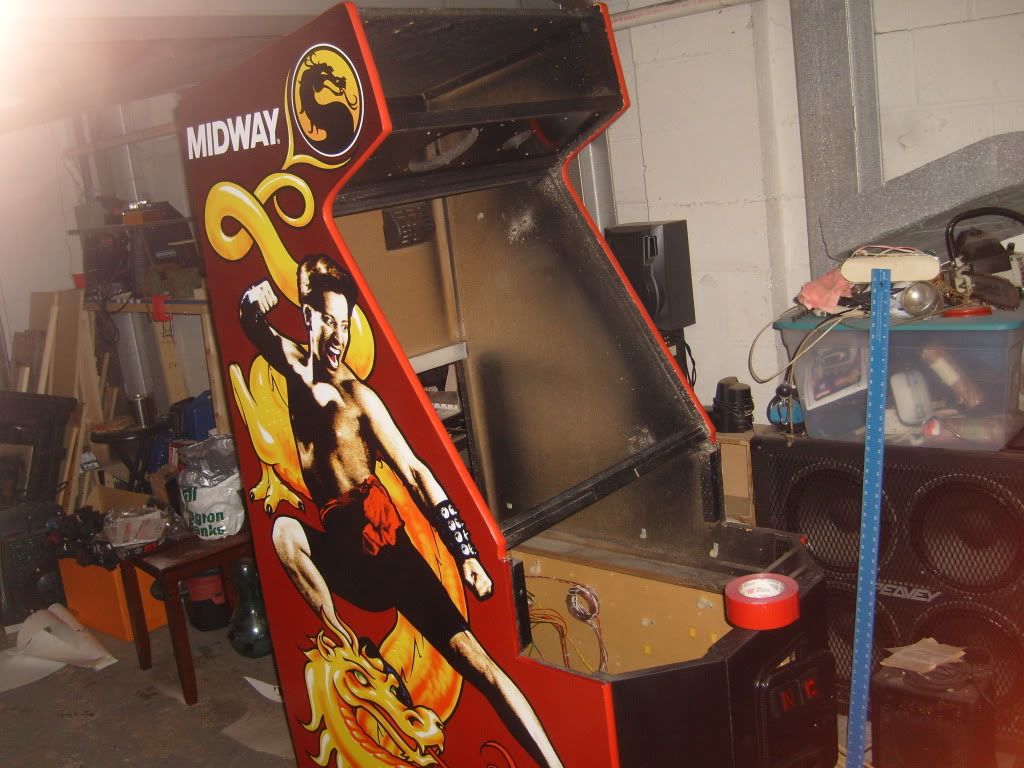

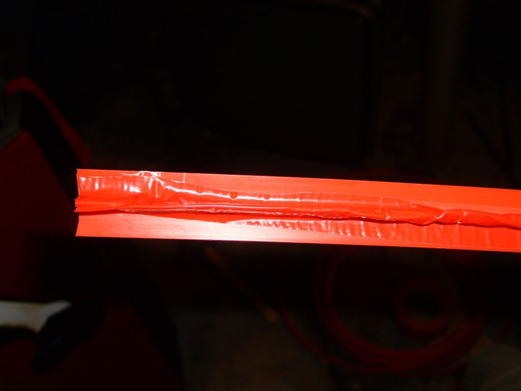

On my Mortal Kombat I bought some red duct tape to match color of tmolding (doesn't matter since you won't see it) and applied the tape on back side of molding to kind of thicken the tongue. Worked like a charm and haven't had any problems since.
I use strips of duct tape, makes it thicker and I have never had a problem with it coming out. I also do the v notch when making corners.
