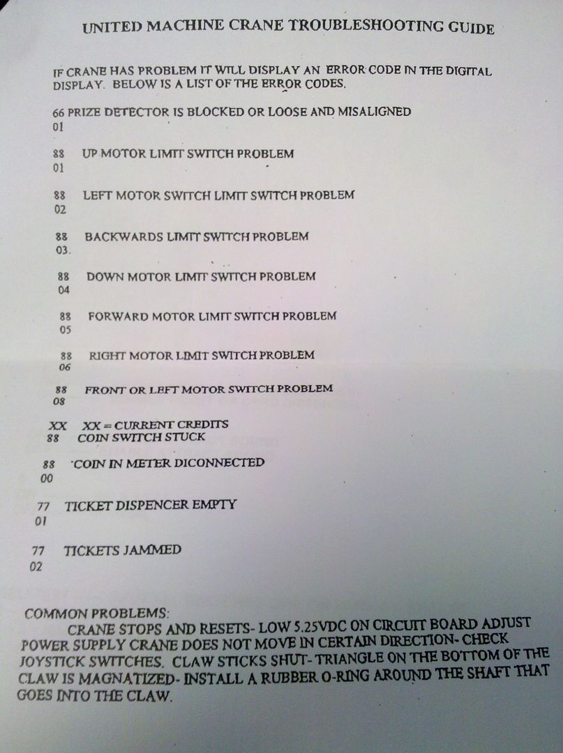

TREASURE CHEST/ GREYHOUND Crane Machine DIP Switch Settings and Error Codes!
I have been meaning to post these up. I seem to be the only one with a copy of them. haha... This is the best I can do right now taking pictures from my cell.
