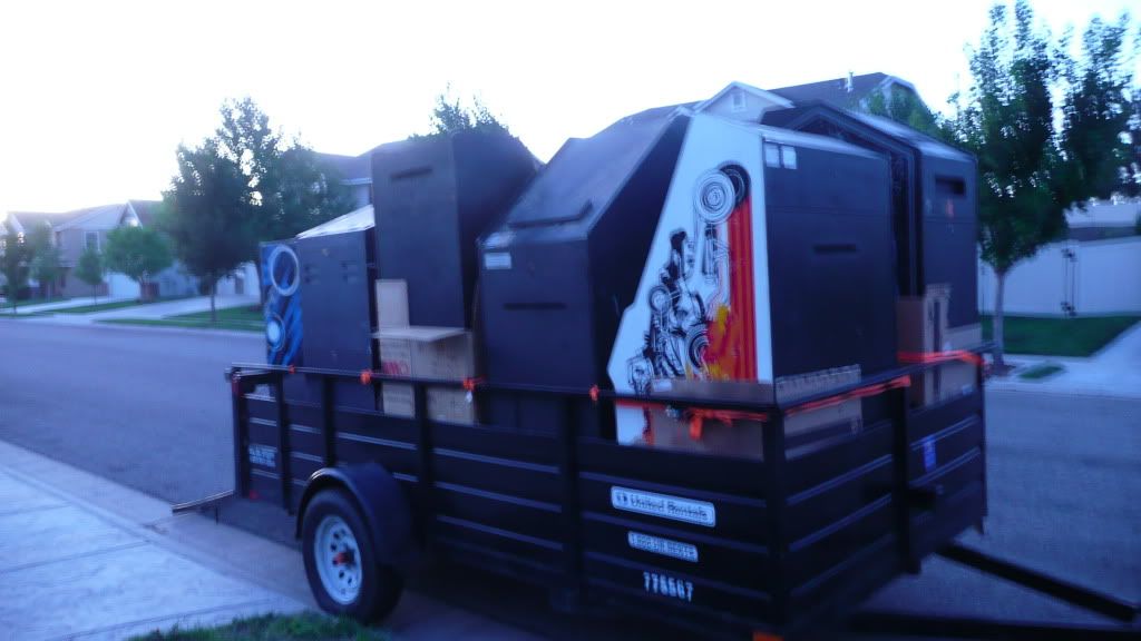

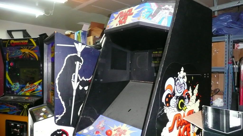

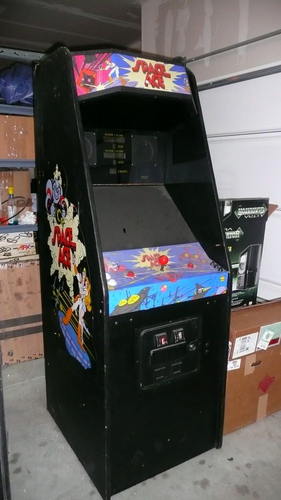

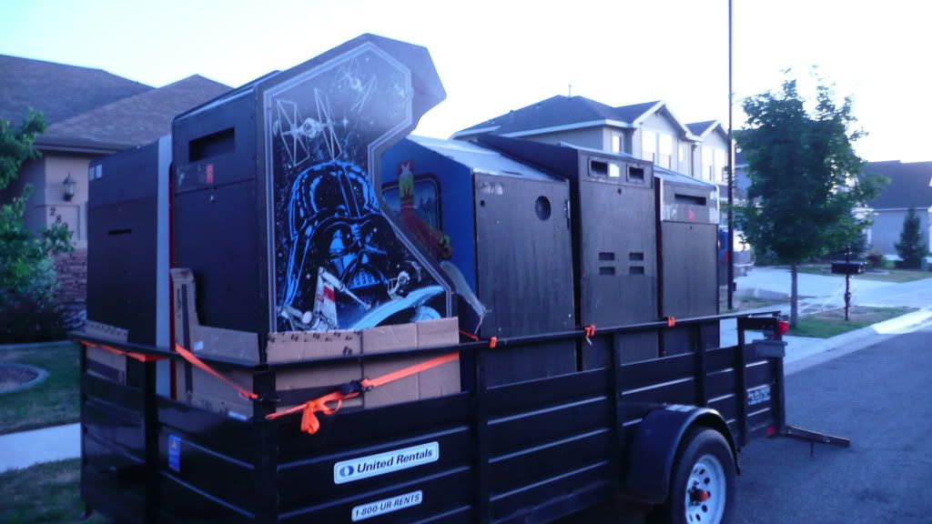

Rolled out the other day and picked up a couple games. Dan ( Hatrick) came along and got the Star Wars ( with an Amplifone) he always wanted. I snagged a Space Ace and we also got a Star Trek( in an Asteroids cab) , Space Invaders, Omega Race, Tournament Cyberball, Sprint 2, converted Mach 3 cabinet, and a Shinobi in a Kangaroo cab. All the games were complete. Congrats Dan on finally getting a Star Wars. Most of these will eventually be for sale.
Thanks for hooking me up with the Star Wars game, Dave.

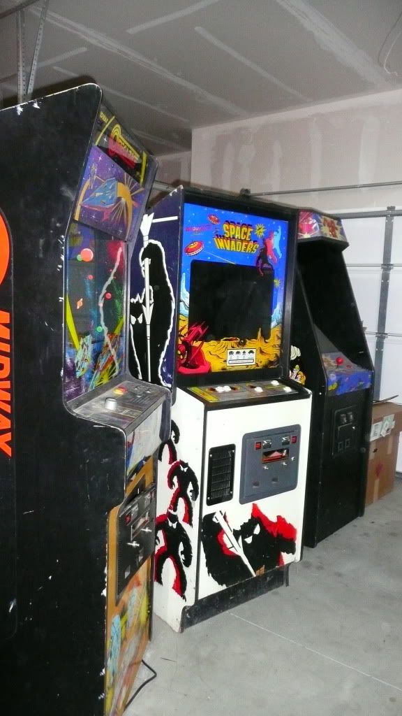

Ya, it wasn't bad. We have made some progress on the games so far. The Space Invaders looked like it had a board issue, the images on the screen were messed up and locked. After messing around with it for a little bit i figured out that the slam switch on the door was smashed together sticking it in reset mode basically. As soon as I pried it apart the picture came up. There were a couple video glitches that went away as soon as I cleaned all the black off the roms and reseated the two boards together. Now it just needs a cap kit. Dan has
