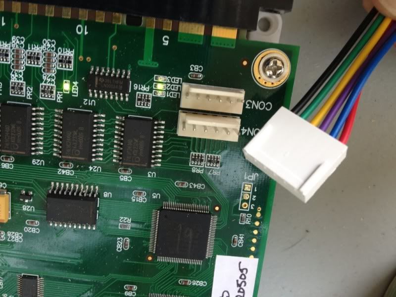

Finally getting around to seeing how a trackball works.
So i grabbed a 60-1, using the connector from Cajun Arcade.
Can you guys clarify how I plug the trackball connector into the 60-1
and what setting in the 60-1 menu will allow trackball to work.
I'm a bit disoriented by the setup so not clear on where to start tackling the challenge.
thanks in advance.
I have already done this and it works.
Plug the harness into con3.
I'm thinking the menu setting for cabinet was upright/ 1 control.
The trackball should work just by plugging it in.
I DID find out that if you are trying to use an original Centipede or a cheap trackball, it will not work with the 60 in 1 unless you replace the sensors inside. Cheaper to just buy the correct trackball! - found that out the hard way!
ah! the simplicity. Thank you.
Plugged it in and worked like a charm.
I bought a 3inch happ from one of the online sites. think it was around 40. glad i chose right because this is all new territory.
hey, centipede moves around decent enough to play a game. fun.
created a pictorial of the process. I'm loving the trackball functionality.
