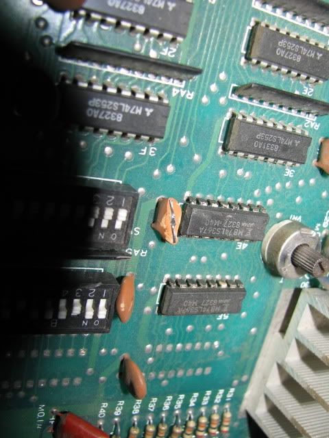

I got this board in the mail a couple weeks ago, not getting any audio during attract or gameplay. I noticed this sheared off cap on the sound board near the volume pot.
Are there any other switches or pots I'm missing for volume? Or is this cap likely the culprit?

Yipe! That cap is definitely shorted out. If that's a decoupling cap like I suspect, it could be bottoming out a voltage that's important for sound. Try pulling it and booting the board without the cap present.
(If that works, I wouldn't leave it that way -- decoupling caps are a stability thing, and that cap missing WILL cause intermittent issues you'll otherwise never figure out.)

Removed that cap, still no audio....
Then either that cap took something with it, or you've got an unrelated problem. Replace the cap, then start board troubleshooting. I don't know that hardware at all, so all I can really offer further is good luck. Hopefully someone that knows T&F can chime in.

PS: That cap wasn't bad... just broken. They get that way and it generally doesn't hurt anything.

Should I bother replacing the cap I removed? Hope I can remember the polarity :p

I don't think that cap has a polarity and it is probably just a filter cap for the ic chips. I have seen techs change the value of a cap like that by chipping away some of it.
I would replace that cap.
Ok, so I put the chipped capacitor back in. I'm sure it's oriented correctly, as the printing on all the other ones face the same way.

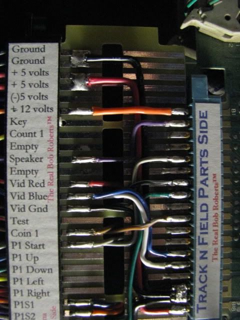

I just noticed, am I missing a jumper on this jamma adaptor?? There's only one for the 12v, on the parts side, no jumper on the solder side.
No. Too lazy to look at the schematics to verify but the pinouts here only show one +12v in: http://www.crazykong.com/pins/Trackfield.pin.txt.
Kind of hard to tell from the picture, but.... Is there only one orange wire coming from your power supply into the jamma edge connector? To me, it looks like you've got the +12V from your jamma harness supplying 12V to the pin on the solder side of the Bob Roberts adapter. +12V on the Konami board needs to be supplied on the parts side of the adapter.
To test, just do a continuity check between the +12 supply on the Konami parts side of the adapter to your +12V output on your power supply (With the power off ....). If you don't have continuity, then try the +12V pin on the Jamma solder side of the connector to the power supply +12V output. If you get continuity here, then you are feeding +12 to the wrong pin.
If you can, pull the orange wire out of it's current location and move it to the same position on the parts side. If you can't pull the wire / pin out, then just jumper from the existing location to the +12V on the Konami parts side of the adapter.

H-sport gets the kewpie doll!
I often use one of the 12v wires to power the coin door light on a jamma cab and like a dunce, I had the sound path disconnected. The 12v wire I had connected was on the solder side.
