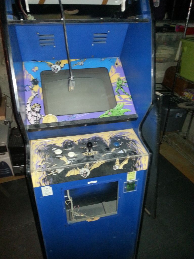

The Restoration Has Begun...
After sitting on the fence for a long time, gathering info and weighing my options, I threw my resto hat into the ring. My fix-up started here http://forums.arcade-museum.com/showthread.php?t=261805 trying to figure out what I should do with a Rastan impregnated T&F machine. I decided to remove the barbarian and bring the old game back to life. I've actually never played Track and Field. Not in the arcade (I was 4 when it came out), not on the NES port, and not in MAME. I'm doing this mostly because I've never done it and I want to see what it's all about.
Goodbye Rastan
I actually did play Rastan BITD. There was a pizza place named Graziano's in Rancho Bernardo, CA that I would ride my bike to in order to play. I'd drop a few quarters, ride home and start the search again for more loose change. 20 years and 1,000 miles later I see a Craigslist ad for an arcade machine in Keller, TX. I live in Arlington and have family in Keller so I say what the hell and head over to look at the machine. It's being sold at Tornado Terry's arcade http://www.tornadoterrys.com The price is right at $50 so I take her home and play some Rastan. All is well for awhile. Maybe I'm just old, or maybe I remember my skill level being higher, but damn that game is tough! After its newness wears off it sits in my basement for awhile until I get the bug and start building a 4-player MAME showcase cabinet. Not knowing any better, I scavenge the coin door off my Rastan in order to make my MAME look cooler. (oops) A few years after that brings us current. Having decided to officially undertake the project I strip and package up the Rastan components and send them off to a better place. http://forums.arcade-museum.com/showthread.php?t=269074&highlight=matt24601 (Enjoy kmk68sin)
Collecting Parts
This is what I am starting with (minus the Rastan):
It has no side art and the control panel has some extra holes to be filled.

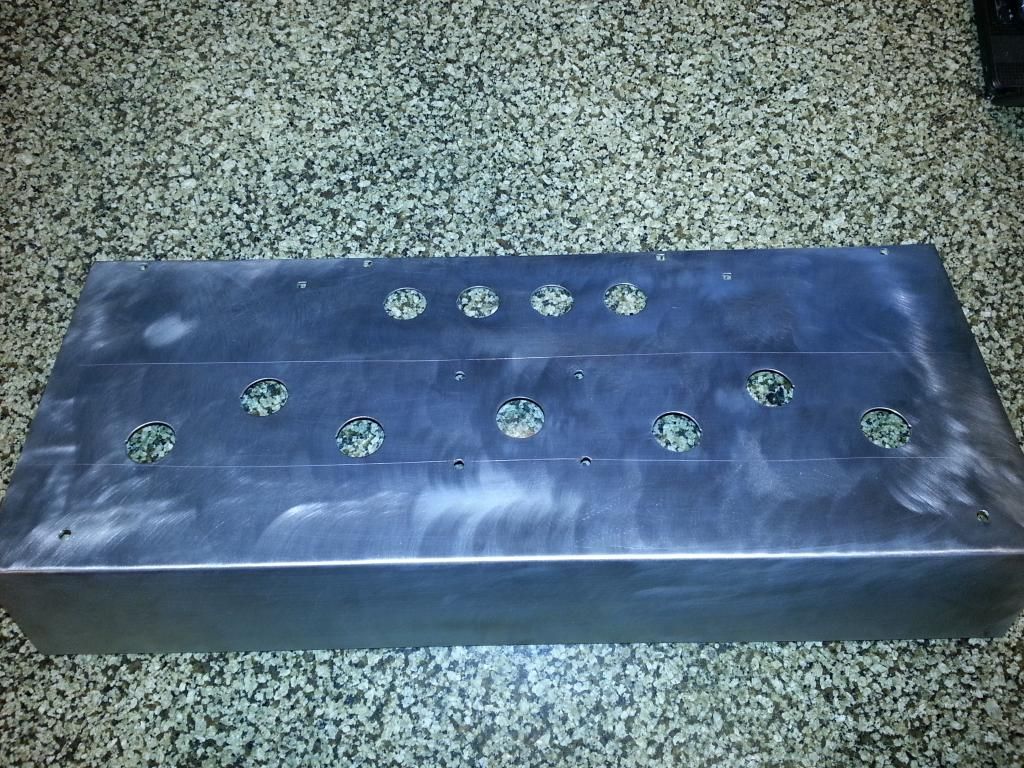

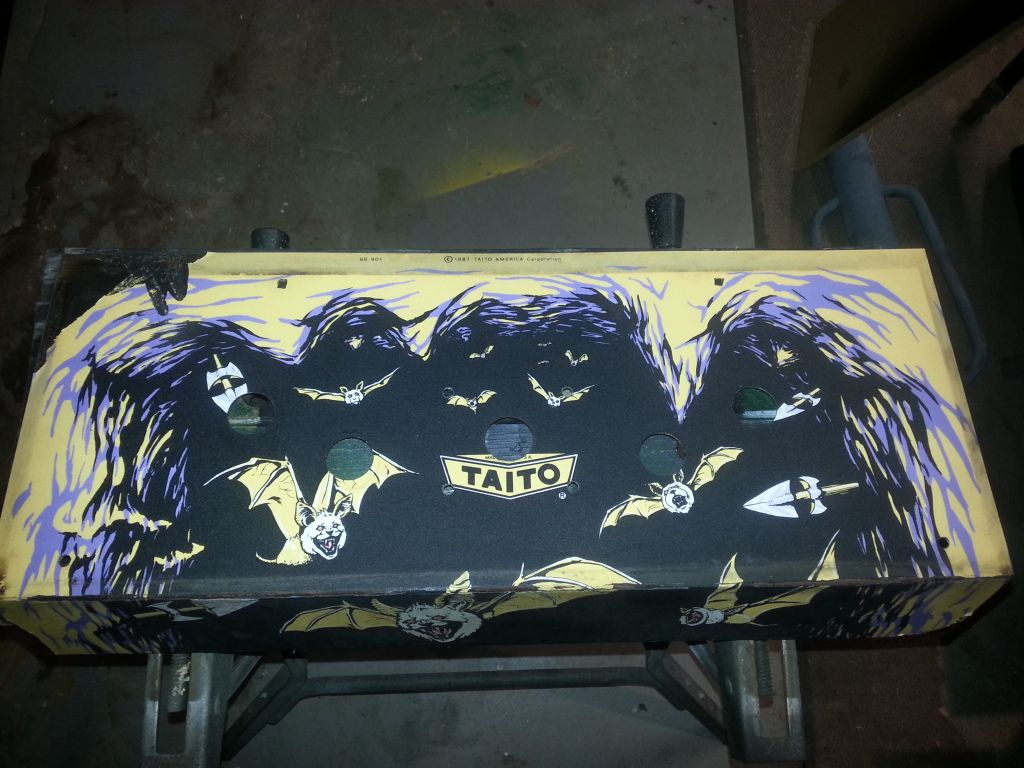

Control Panel
Stage 1 control panel
[/URL]
Stage 2 control panel
Stage 3 control panel TBA
Stage 4 control panel TBA
Stage 5 control panel TBA

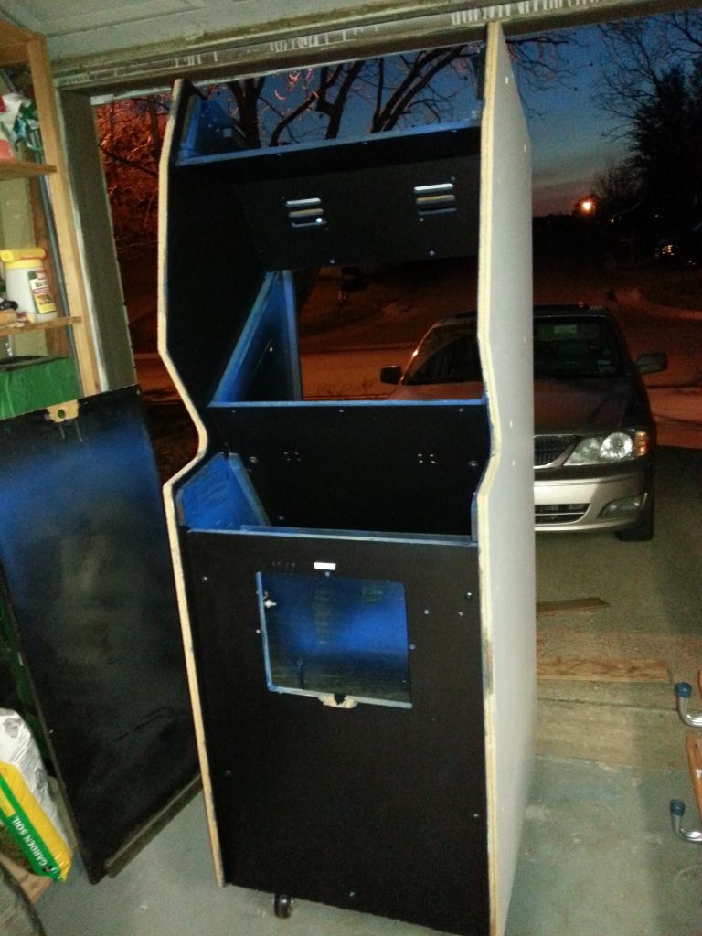

Prepping the Cab
The cabinet is in pretty decent shape. Corners are busted, there's some chip out in a few places, a bit of swelling around some of the edges, etc. After stripping out all of the guts, I layed in with the Citri-strip. That got me here :
I then went to work on the corners and edges. This corner was the worst offender. I thought about chopping it out and putting new wood in, but it was really only chipped out from the t-molding slot up. It still had half the board as backing. Too big for Bondo, I used Bondo Hair which I've used for structural patches in fiberglass in the past. I think it'll hold up well.
To get the corners I tacked and clamped some wood strips as guides.
After filling and sanding you end up with this :
