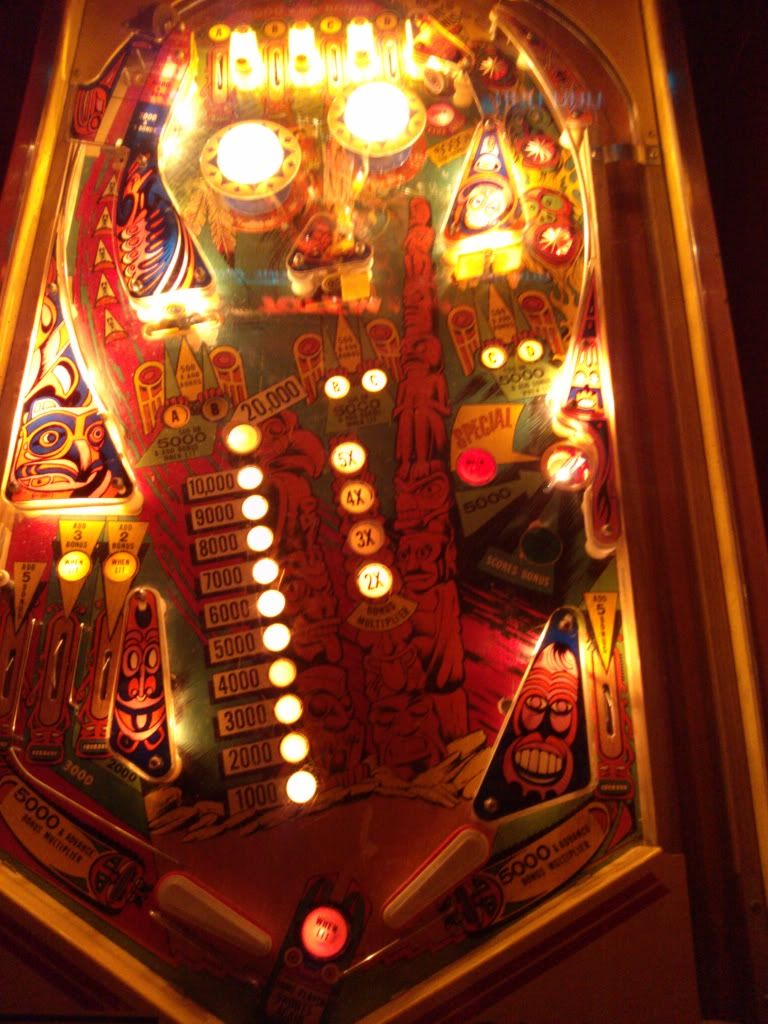

Hey guys, I've got a Totem by Gottlieb that I've had for years, and its minor (I think) issues are starting to bug me a bit... figured I should take a run at fixing it.
My major issue is that most of the lights on the playfield never dim like they're supposed to. For example, the strings of lights for the bonus and bonus multipler (vertical lines of 10 and 4 lights.) Any idea what could cause this?

Could certainly be grounding issues. Check the cable going between the MPU board and the driver board, and make sure there isn't acid damage on any of the pins. You can re-pin the cable, or simply buy a replacement.
Good troubleshooting information:
http://www.pinrepair.com/sys1/index.htm
and
http://www.pinwiki.com/wiki/index.php?title=Gottlieb_System_1
Between the two of these, there's a lot of good reading and troubleshooting suggestions you can follow to isolate the source of your issues.

Also, the link the person before me posted about fixing/bullet proofing System 1's. DO IT. Do all of it. Do the cap swap, do the grounding mods, do the diode hack into the harness between the CPU and Driver. Its worth it.

I am pretty sure you have a problem with your driver board. There is some good data on pinrepair concerning this.

All of the lights go on and off when they should; the scoring works perfectly fine (except I think the A and D rollovers may have "tied themselves together), problem really is primarily that the lights don't dim fully when they should. Would that be a driver board issue, not grounding?

It literally takes like five minutes to ground the driver board and computer board. Try that first. If its not that, Then I would look at the driver board.

Will do! Only reason I haven't done the ground mods already is I haven't yet had a chance to make it to the specialty store that carries the parts I need for the memory capacitor mod and replacing the power supply cap (which I would be attaching the main ground wire to.)
Looks like the transistor test on the driver board is easy enough to do; I may go ahead and pull that tonight and check it.
