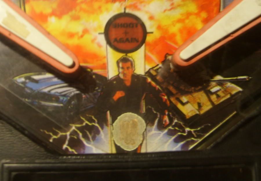

Has an audio issue - after a minute or two the sound cuts out...something's overheating...shouldn't be too hard to fix. The DMD has a missing line at the bottom ...outgassing maybe? Not too noticeable, though.
I played it for the first time at a show a few years ago and thought it was pretty cool. I dig the magnetic satellite dish and Bond's magna-cock saver....speaking of which:
Yikes....his James Bond Jr. got blown off! I'll have to fill it in/touch it up. It's pretty sweet though - the magnet saves the ball and flings it back up into play!

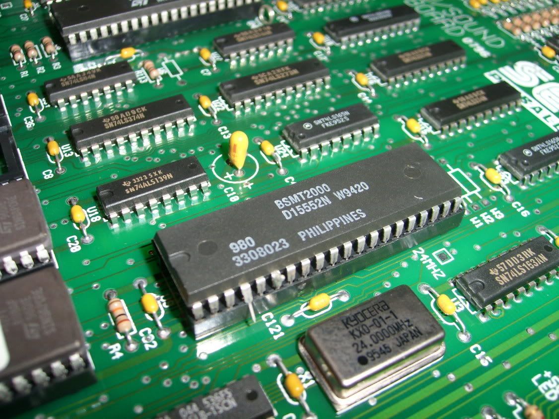

Yay, I fixed the sound problem! I took the board out to test the caps (InstantArcade brought over his scope) ...and he noticed that the BMST2000 chip had a leg bent out of the socket! Put that thing in correctly and now I have fully functioning sound! YAY! :)
On the sound cutting out. I have found that often all you need to do is pull the sound rom, clean it a bit, make sure all the pins are straight, and reseat.
This game has 3 sound roms, but also a BMST2000 chip - that chip had a leg bent out that wasn't in the socket...once I fixed that, problem solved!

BTW, this was the cause of my sound problem:
