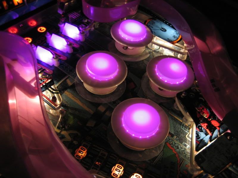

I have a Genesis and love it. Just put a few purple LEDs in it and it looks really good. Gonna have to order some more.

I would like to see pics of that..... I was thinking putting led's in the pops...

I will try and get some pictures later tonight. I only ordered 10 just to see what it would look like. Wishing i would have ordered more.
Here a few pics of my Genesis with the purple LEDs. Was hard to get good pictures. Definitely looks better in person. Gonna order some more to try in the rest of the GI lighting.
