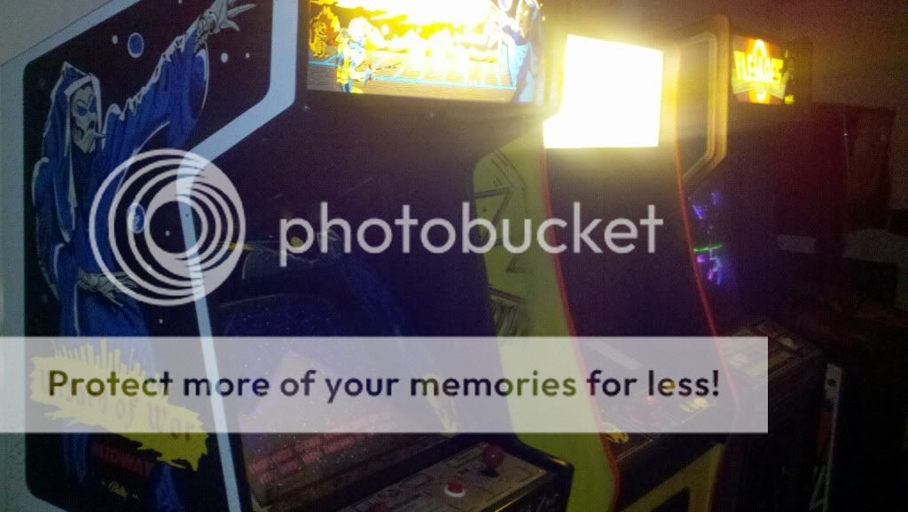

Today's Pick Up Wizard of Wor

grabbed it for 100. world of crap thou.
first it isn't working. he said when it did work the monitor would cut out after a half hour. then he turned it on recently and now the screen flashes and no noise. so i am going to open it up tomorrow and see whats going on. anyone work on these boards?

Currently not working. onto the help page once i see whats going on. Any opinions on this game?
