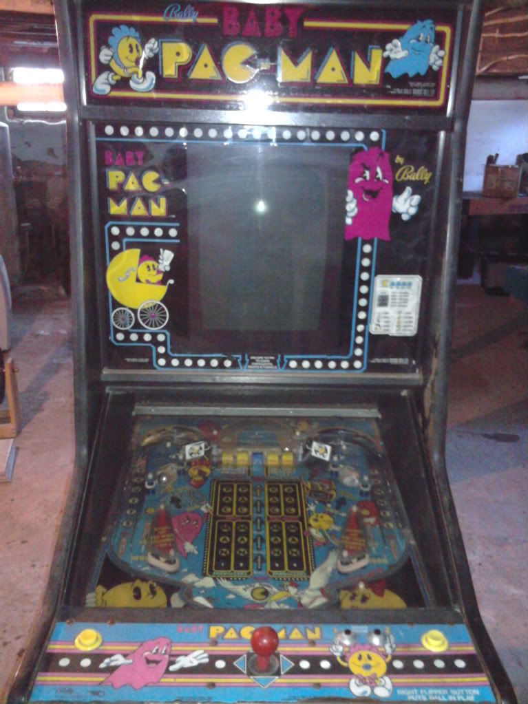

Today's Pick up - Baby Pac Man
nice score. doesn't look in too bad shape. hopefully it'll fire up and you won't have any mpu or vidiot issues...
Thanks, everyone. Hopefully I'll be able to check it out tomorrow. I looked at it before running out to class and it looks complete! The playfield lloks to be in excellent condition. The bezel has some issues and the marquee looks good. The back door is a complete loss but the cabinet is solid. The top is chewed up in the back for some strnge reason. Tomorrow, I'll fire her up. Wish me luck.
How can someone possibly buy a new game and not plug it in as soon as they get home??
Got this off CL today. Paid $250. It's in pretty nice shape. Don't know if it works.
Thanks to my brother and nephew for picking it up.
Steve, sorry for sniping in your neck of the woods. LOL

Its a baby pac, of course its not going to work. You need to spend hours making repairs and upgrades to it before it will be reliable.
I Agree with Riptor doubtfull its gonna work. I've rebuilt 3 of these and your gonna be cleaning pins and connectors and reflowing solder points till you can't see straight. Hopefully your vidiot is good. Keep us posted and nice pick up.
Joe(acejedi)
on the sound issue - there's 2 sound pots. One is in the bottom right hand corner of the vidiot. Make sure its not turned down. The second is either on or right inside the coin door. Make sure its not turned down.
The one on the vidiot is notorious for going bad. Thats the first thing i'd do if the volume's not just turned down.
Joystick not going down could be a number of things- bad connections, dirty leaf switch, or one of the 6821's on the mpu are all good places to start looking.

Update!
She works 100%!!! Reseated some connections and now I have sound and 4-way joystick control! My son loves playing it. Now to clean her up and make her pretty again.
Thanks for everyone's suggestions and wors of encouragement. Even you, Tighe. :D
