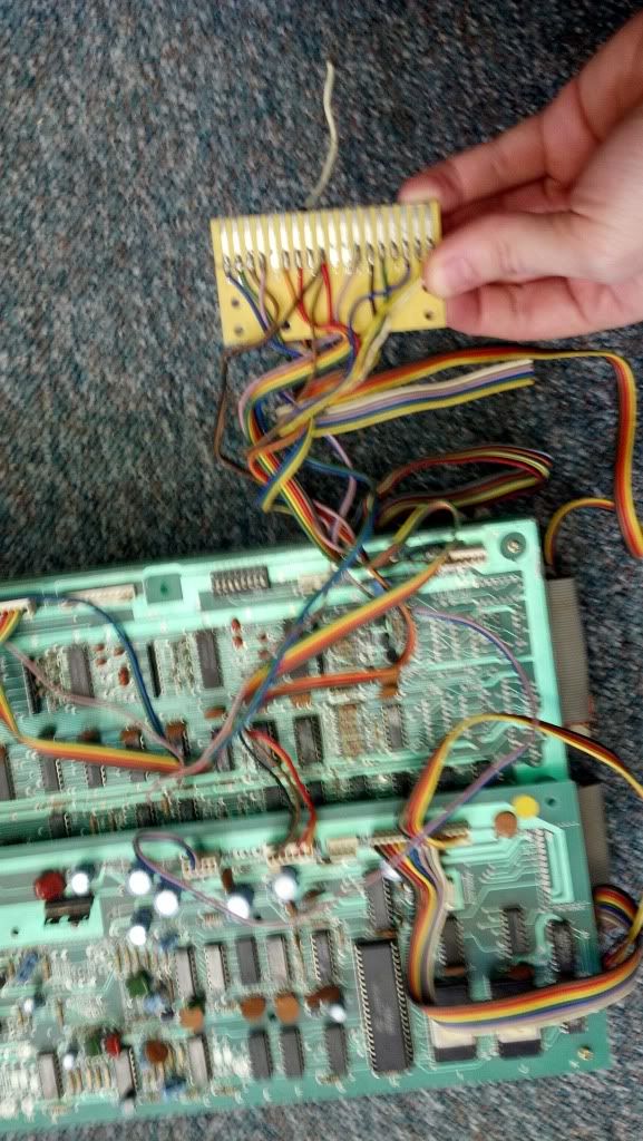

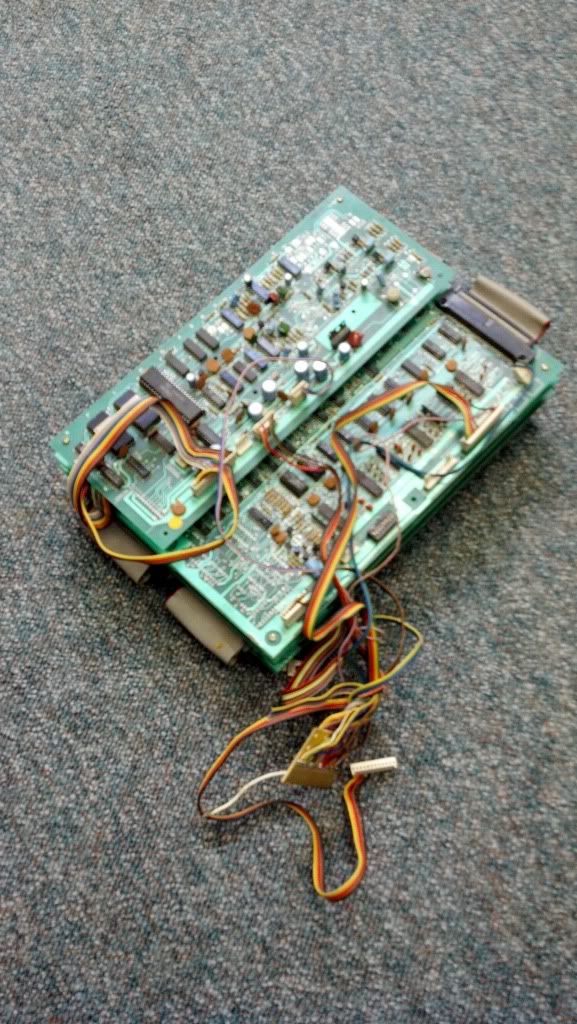

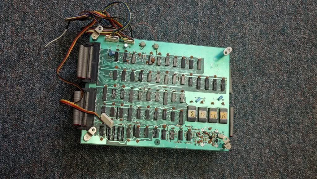

What the heck is this? Looks like someone put an adapter on it to play in a... atari 2600? I'm confused.

I ran into one that looked similar a while back, The one I ran into was a Donkey Kong boardset that was running in a Congorilla cabinet. The Atari cartridge looking part plugged into the Congorilla harness. I assumed it was a clone boardset, the levels played in different order than a normal DK board.
Agreed. Probably a bootleg Donkey Kong or something similar. That little board is just a fingerboard, a method of attaching a board like this to the edge connector harness in some other cabinet.

Very well could be a bootleg. A few friends of mine thought it looked like a Nintendo board, but it has no markings or logos on it anywhere. Even the rom chips are just numbers.

Yeah, I'm also gonna say it's a Donkey Kong clone (but not Crazy Kong)...I have one that looks similar, although it's 3 boards, and the bottom board is huge. The top board looks just like the one in your 2nd pic (minus the little connector near the top...mine doesn't have those populated). I haven't fired mine up yet, but I got it from Steph, and he ran a few of the roms thru romident and said it was DK. It's got the same sound processor as DK (8035). CK uses an AY-3-8910 PSG for sound, so I know mine's not a CK clone.

Also, after looking at mine, I believe these DK bootlegs are just clones of a real DK 4-board stack, but mine actually has the audio half-sized board and the CPU board together as one, so it's only a 3-board stack (like if you mixed one half of a 2-board stack, and the other half of a 4-board stack of a regular DK board)
