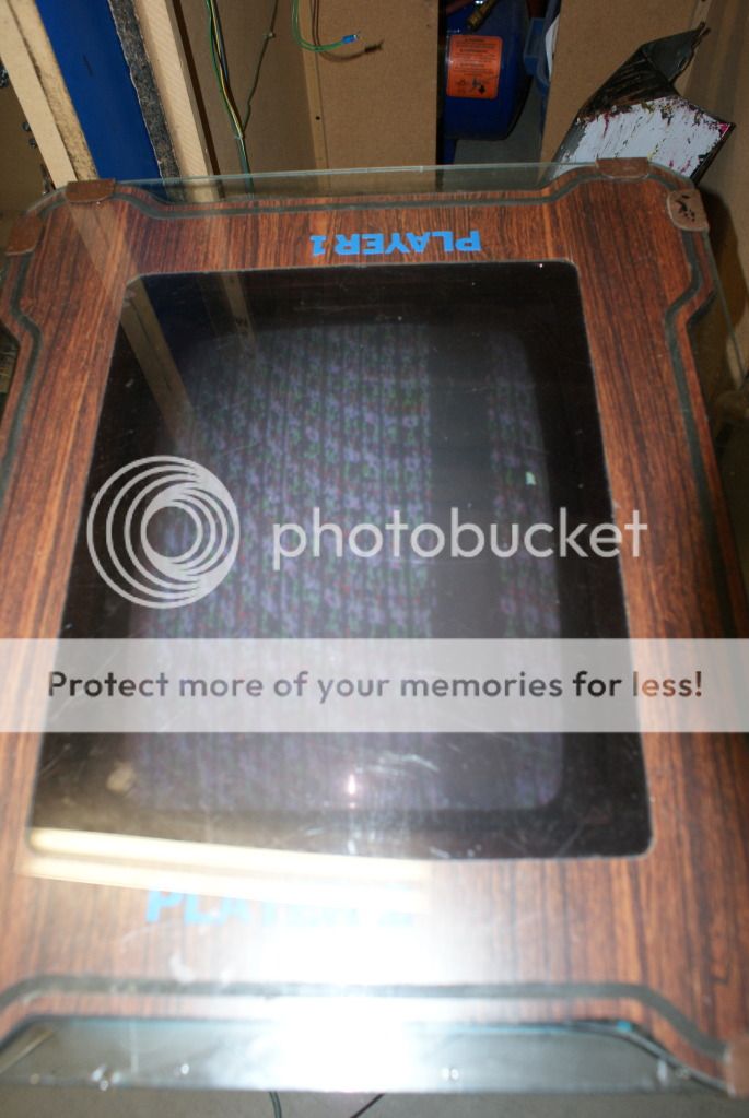

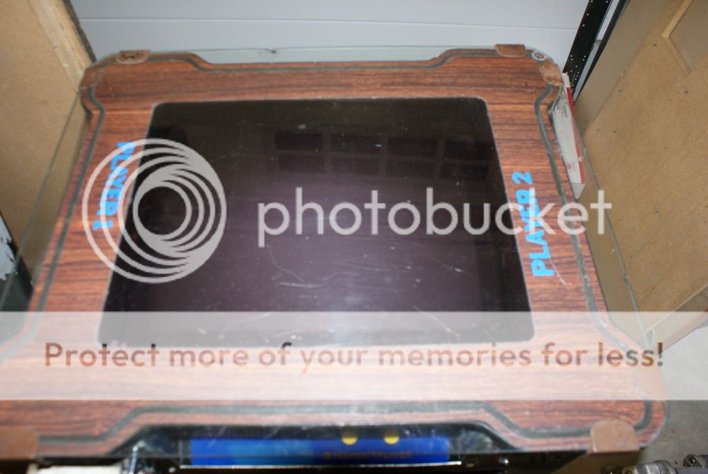

Nice score! Hopefully you will let someone reproduce that tall cocktail style cab. I know alot of users here were interested in it. Does it have any Nintendo tags anywhere on it?
Looks like it might have been converted... Then again maybe not.

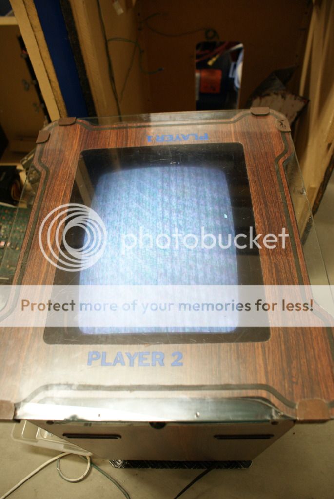

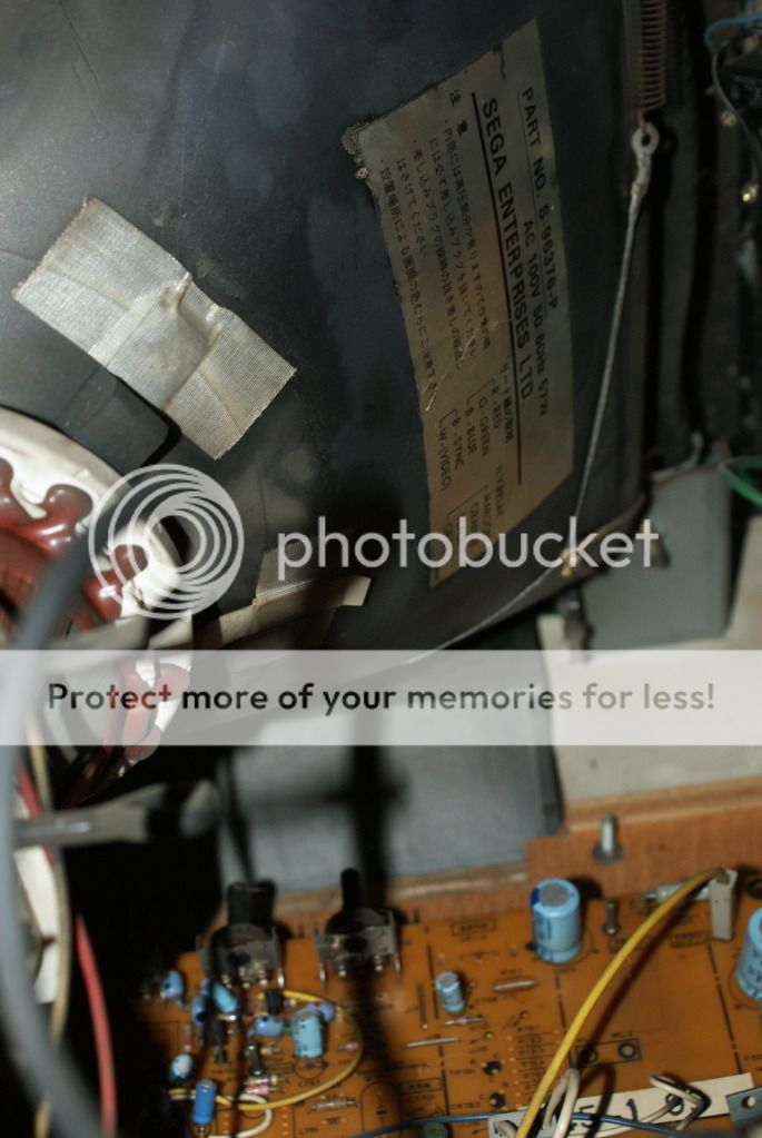

I just couldn't resist. I had to try plugging it in! Last owner said he couldn't get it to start. Probably should have checked the on/off switch on the bottom! Looks like the chassis needs a rebuild. No burn in on monitor. Its obviously a 13" tube. Can anyone identify the chassis? I'm going to have to do a cap kit.

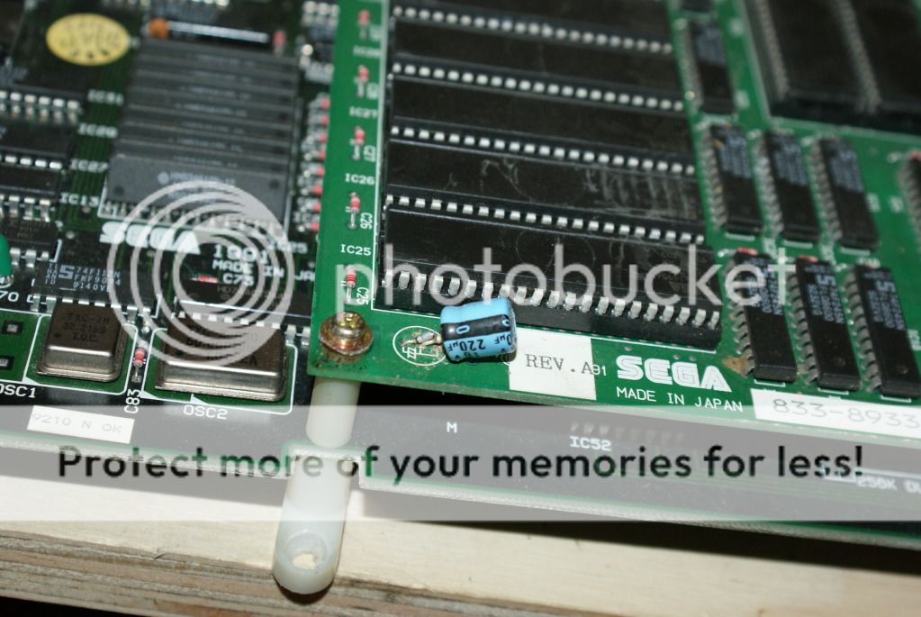

Well.. Golden Axe 2 had some cap issues... replaced 2 and game fired right up. Played up to level 4. Kinda getting hooked on this game... even though I only tested with 2 buttons!

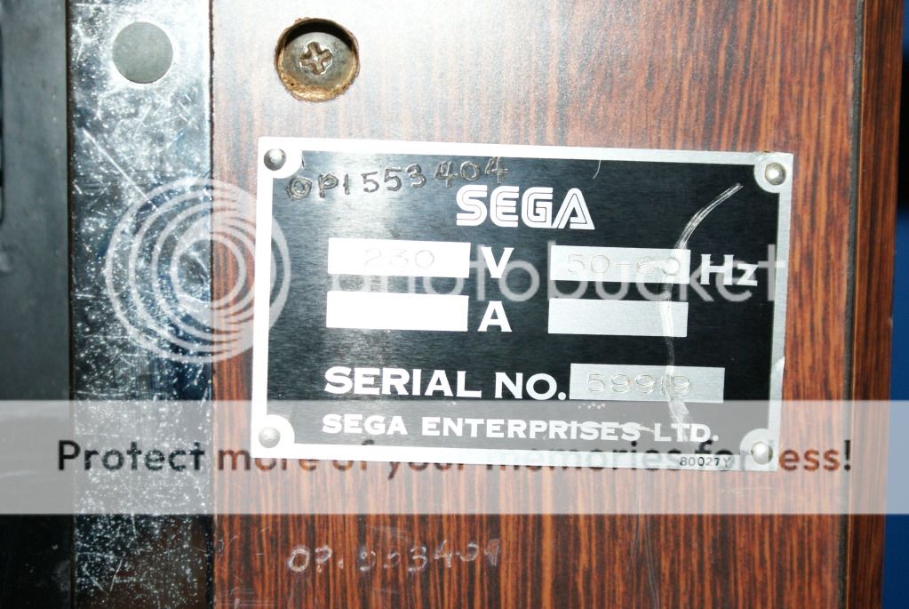

Sweet cabertail/cockaret! I bet all of the ladies will flock to your place now.
No really though, all of the Japanese labels, the Sega plate, interesting design choices...
