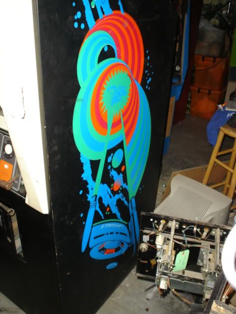

well he said he had a monitor for me walks me up to one of the rows in his warehouse and says there it is
i am greated with this

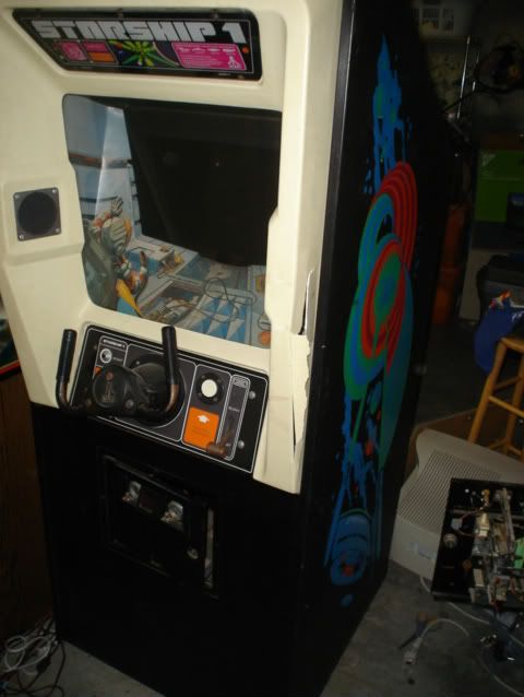

its an atari starship 1 with pretty much perfect side art totaly complete but only partily working only bad thing is is the plastic shroud is cracked all to hell

The bezel could probably be patched up with crazyglue and something to reinforce it from behind unless it is brittle from UV exposure.

was digging around in the cab pluged it in game would not come on (just got a constant ringing sound)
checked the manual and then tested voltages as the conector
10v ac is at 9.89
25vdc is at 14 .xx
well looked around a bit more jiggled some conectorrs pulled them appart and reseated them
hit the coin switch to coin it up and see it would play blind bam i got an immage on the screen arggggg
tried to play and it would not start and i still had the constant ringing screeching sound
dug around a bit more and found the test switch fliped it the other way bam now it plays
now for the bad seems to work ok but i can move up and left and right but no down being that its a pot based control system that does not make much sense unless the lower secton of the pot is bad
the other problem is the sound is present but verry low
dmmit now i have to figure out what empty cab i have is getting the axe my stern pac or the cheif cab that my gorf was originaly in
anyone local need any empty cabs

reinforce the cracks and missing areas by using this special chicken wire looking stuff that has an adheasive on it so it sticks in place then use bondo to patch it up sand smooth apply texture if needed (the shroud looks pretty smooth so i probaly wont bother with a texture )then spray the entire thing with sem plastics paint to cover the bondo and to make it look all nice and new
well just about got the thing restored
cleaned off the bezl glass, the monitor tube, and the half silverd glass. and now i can actually see a nice bright immage of the game weeeee
upon removing the plastic shroud found why the marquee was not lit (and why the plastic is broken up)someone undid the top three screws on the plastic shroud and then pulled the top of the shroud out to totaly remove the light fixture without removing the cp wich is what cracked the plastic
installed a new fixture
adjusted and cleaned the pots on the controlls now i can move all directions
was going to start on the plastic repair but it started to rain so that will ahve to wait
and need to find the horz pos adjustment and it will be done
here it is working fully and all lit up
