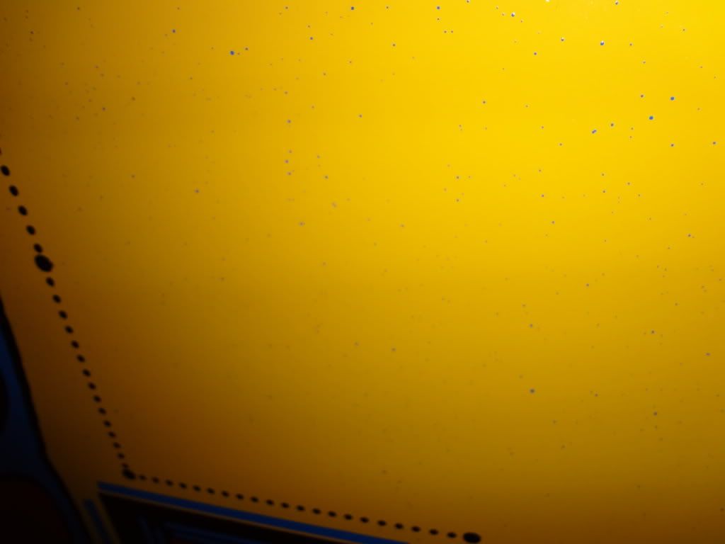

curious when people redo pacman with stencils do they go so far as to add the little blue sort of specs that are in the originals?
Would think thats a tough thing to pull off right.
I did on mine:
I just used an old toothbrush dipped in blue paint to flick it onto the cab:
