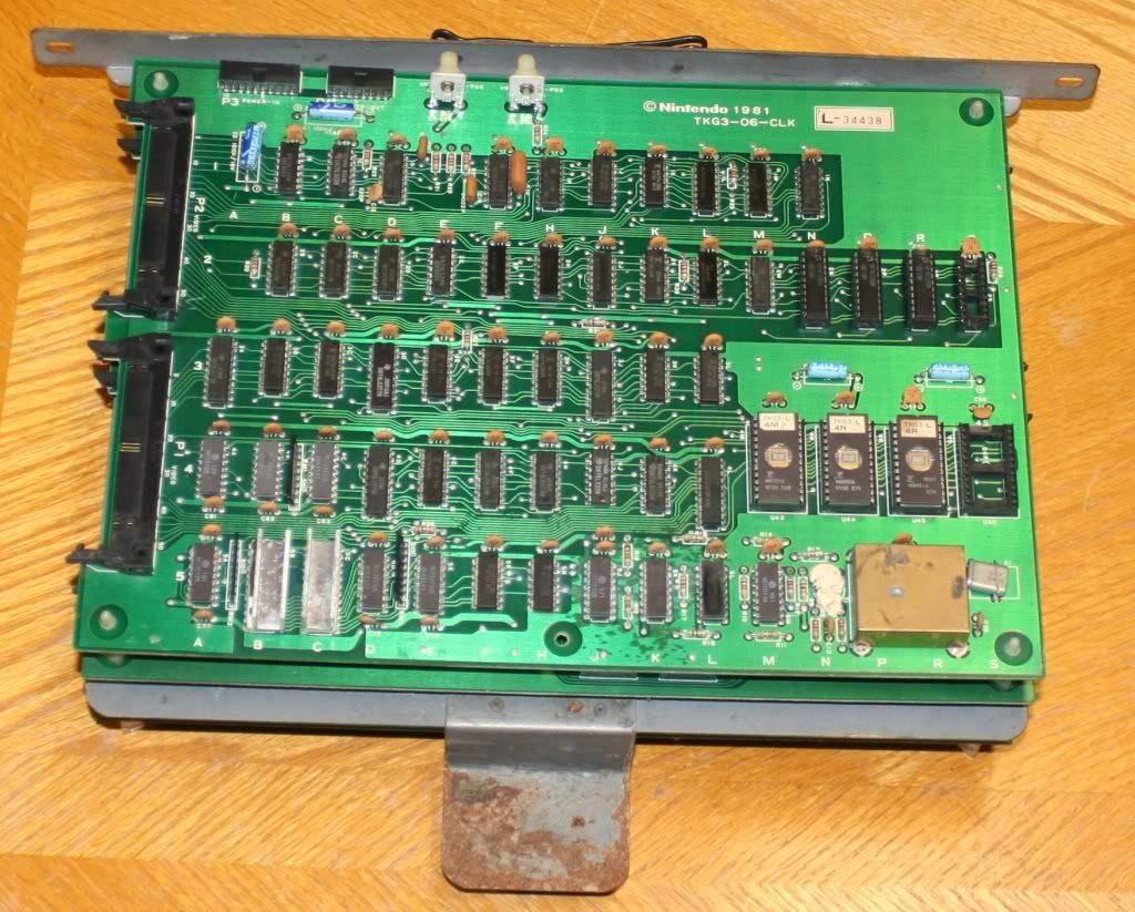

I donned some rubber gloves and took apart the 4 boards, removing them from the frame. I removed every socketed chip and set them aside. I will test them in my eprom reader later, to make sure the data on them is OK. Interesting thing I noted on this board set - on the clock board, 2N, 2P, 2R, and 2S are all socketed. On my working 4 board set, these 4 chips are not socketed. Does that mean that this board set has been worked on before? Not sure.

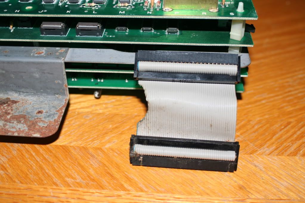

1. The ribbon cables are all shot. Chewed up. How hungry do you have to be to eat a ribbon cable? I don't know, but try asking the mouse that took THIS bite:
The other 3 cables are all damaged as well. I'll need to replace them.

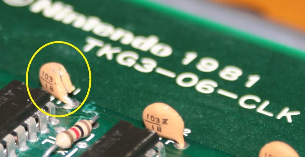

I also noticed a ceramic capacitor on the clock board is damaged. Not sure if that will affect things, but it would be a good idea to replace it:

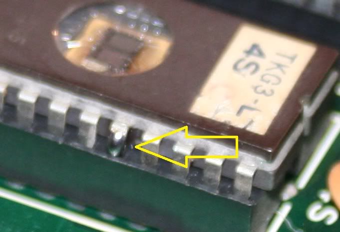

There's also a leg on eprom 4S from the clock board that's about to fall off. I'm not sure if it's a leg that's redundant or n/c, but I'll figure that out later. The leg is barely hanging on by a thread right now, so I'll try to repair it. Unfortunately the near break in the chip leg is about half way down, so to repair the chip I'll probably have to clip the leg off a bit higher and splint on a donor leg from a junk chip. Not sure that's worth doing to an eprom chip that I can replace for a couple bucks. Does anyone have a quick jpeg of the eprom pins and what they do? That way I could determine if my problem chip leg is an issue or not.
Also, I seem to be missing a chip on the clock board. It's the one at 2S. Google search tells me the chip is an 8 bit universal shift/storage register - Texas Instruments. Anyone know where I can get this chip? I don't think I can test the board without this chip in place.

The 299 is not ram but an 8 bit shift register I believe but any way check your Eprom data the chip in your picture missing was eprom 2716 4S but I would verify all chip data.
Pulled out my own 4 board stack to troubleshoot this board set. I started swapping boards from Jehuie's board set into my own to narrow down the problems. I found issues on the clock and CPU boards. Clock board had 2 eproms that had bit rot, and I had to replace the one missing eprom too - all required erasure and programming.
The CPU board had bad eproms at 5F, 5G, 5H, and 5K. I had to erase and reprogram them all.

Small update to this thread. I was able to repair the damaged eprom today. I bridged the weak spot in the leg with a trail of solder and it stiffened the leg enough to get it socketed again. I re-programmed it and placed it back into the board.
Why bother repairing a busted leg on an eprom that could have replaced for a few bucks? Well, because I can, for one. Also, now all of the orginal roms (with the original labels) are back together again on the boardset.
