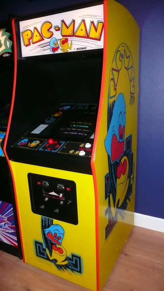

So, I have a pacman cp that is in need of repaint, thing is, I completely scrubbed the cpo down and it is immaculate. Anyone have any tips on how I can strip and repaint the control panel without disturbing the perfect original cpo, or is that more trouble than its worth? Thanks for your input!
My original overlay was in nice shape so I taped it off with blue painters tape and newspaper and repainted around it. It came out good. Tape off the overlay before you sand the old paint off too so you don't scratch it up.
I just did this.Tape off the panel with painters tape and newspaper and use rustoleum stain black.Both post above are 100% correct.Mine turned out great! Keep playin with your joystick!
