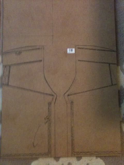

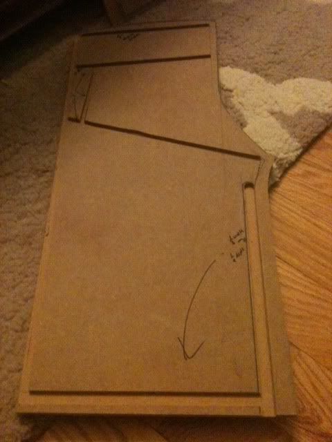

To start off, here's a terrible picture (phone!) of the drawing on MDF:

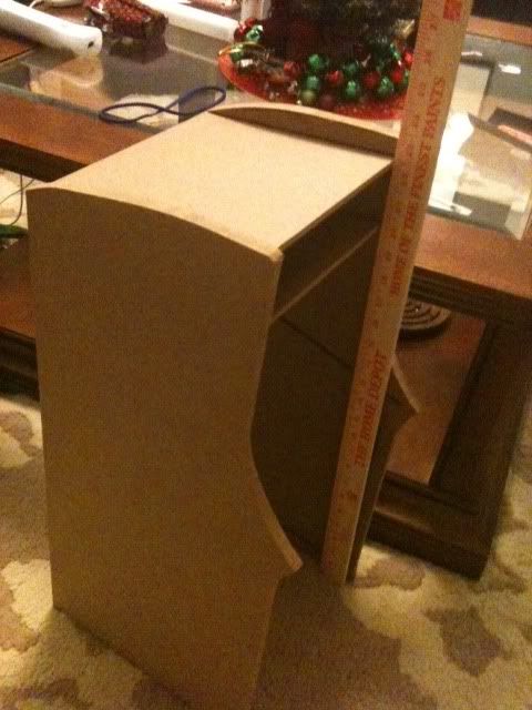

A little progress today: routed the sides and cut some additional pieces. Apparently my 1/2" MDF is slightly bigger than my 1/2" router bit. I'm guessing the mdf is off by about 1/64 or maybe 1/32. Either way, it's enough to not fit. So, I have to file the grooves a bit and then see if they fit better.
The whole project is supposed to just slide together...add a little woodglue and clamp...and it's done.
Pictures:
Bad pictures again...but you get the idea. a whole 23" tall!

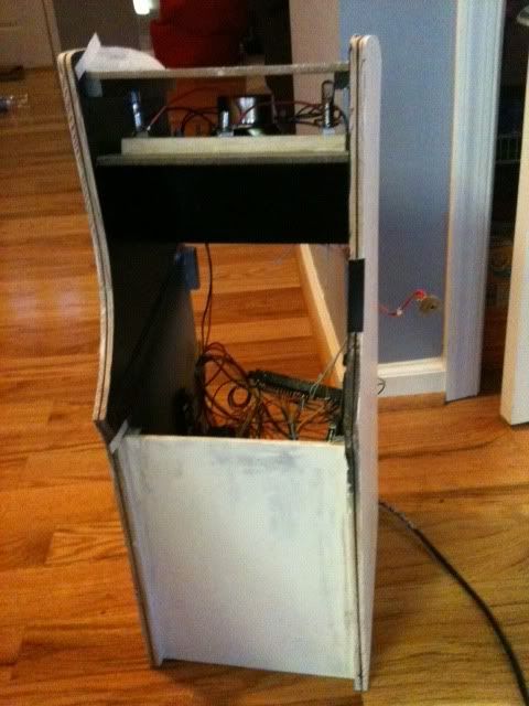

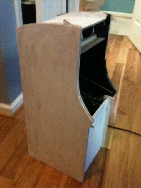

I ran into a problem and had to recut the sides. I forgot that when I would cut the T-molding slot, it would slice into the grooves that held the top and front in place. The cabinet is just so small that the cuts would hit each other.
So, I recut it and just used glue and dowel rods to hold the front and top in place.

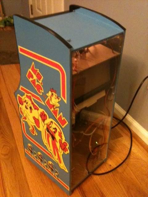

I've assembled it and wired it up (it works!!!) and recently primed it.
Tonight I will paint a coat of Ms. Pac blue and when it dries I will put on the side art.

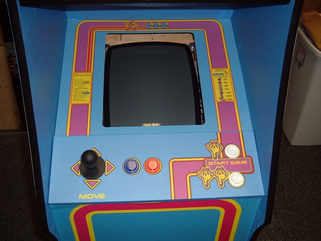

I'm still not sure what to use for a control panel. It has to be 2"x2" at 90 degrees. That's what I've planned for. There are pieces of that at Home Depot, but only in 6 or 8' lengths and at $37...I don't want to spend that for my mini CP.

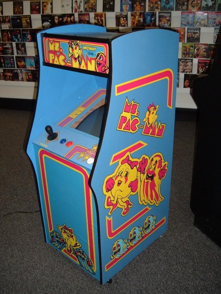

Here is my mini cab that I made, its 4 ft tall, 2 ft deep, and 18" wide.
You can PM me about the artwork. I did a custom control panel for a 60in1 and regular size joysticks and buttons. I also did replace the Super joystick with a pink ball top. That was what I had at the time. I laminated the sides with Formica counter top I bought at my local hardware store. I didint laminate the from and just put the artwork on wood and got wrinkles, so I pulled it off and reprinted a new piece and put it down on laminate.
-Jake
http://s224.photobucket.com/albums/dd291/billybob2236/mini cabs/

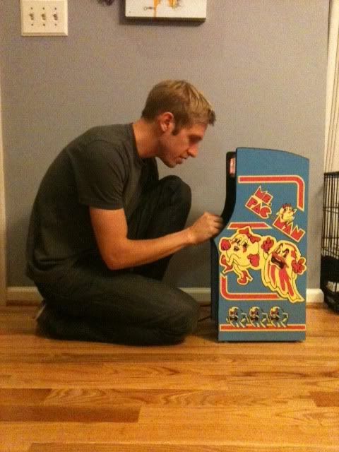

Got a lot done tonight....
Next up: mount the monitor.
Finally...figure out what to do for the control panel.
As a side note, yes that's Zeke from Zookeeper on my front door.
And, ignore the little piece of white tape holding on the marquee. Just wanted to see what it looks like lit up.

Well, I know how it will be done as far as size and shape. I just need to find the right material to make it. I'd rather not use wood, but I know that's an option...so I'm not afraid of it not working or not fitting, just not being the material of choice.
I'm open to thoughts on what to use, though. Like I said earlier, it has to be a 90 degree bend and 2" x 2".

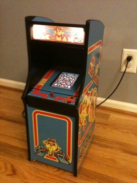

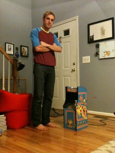

Almost finished.
This project has been slow going. I used a piece of aluminum ($3!!) for the control panel.
It is fully working except for one odd thing, it will not start a one player game. I thought it was the wiring, but then I touched the ground to the actual contact on the board and it still didn't work. The two player game starts just fine. I'll look into it some more tomorrow. It was working fine earlier today.
A couple pictures are below...you'll notice the player 1 button is still missing from the CP, but that's about it.
Also, I decided to give it a clear plexi back door. I figured people would enjoy looking in and seeing what's inside:
And another just for scale.

I originally had the idea a few years ago. I teach middle school math and during the unit on proportions I had the idea to build this scale replica of one of my games to bring in as an example of using proportional reasoning to build something.
I also just kind of wanted a fun project to see if I could do it.
In the end, I think it will just be a funny little conversation piece that sits in the corner of our gameroom or in my fiance's art studio and gets played just once in a while.
I swear, though, it was harder to build than a full-sized game (which I've done, too!).
Also, I have no idea what to do for a coindoor; it's currently on free play.
