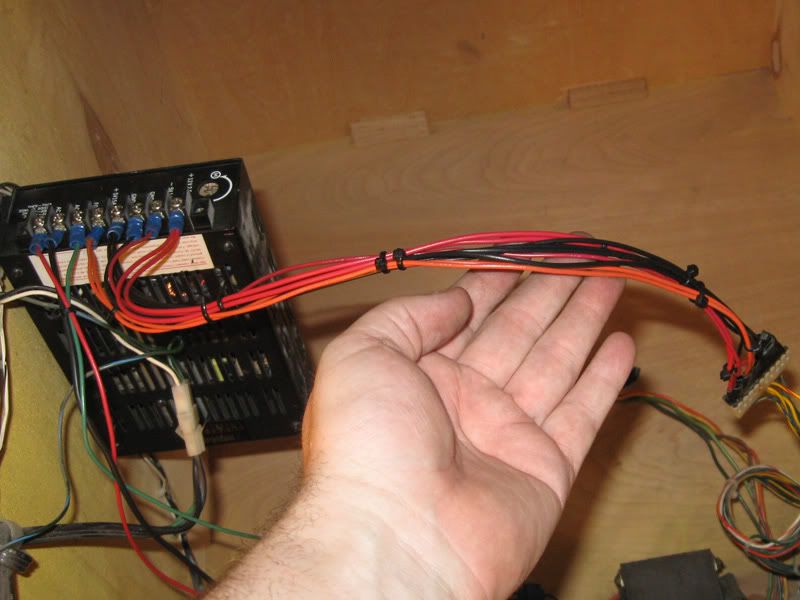

Alright, I picked up some breakaway .156 connectors from Bob. I am going to build a harness to plug Scramble in to a switcher...
What is the "proper" way to attach wires to this connector? Just solder each pin? Solder and then use some heat-shrink? I know this has GOT to be a stupid assed question...
You need the female harness side Frizz that slides onto it. you crimp the pins on the wires and insert them into the harness side plug.
The female side is attached to the Scamble harness. This connector will then attach to wires which will then go to the switcher. So my natural assumption is just to solder the wires to the short end of each pin...then heat-shrink (i wonder if I have sany heat-shrink)...
The female side is attached to the Scamble harness. This connector will then attach to wires which will then go to the switcher. So my natural assumption is just to solder the wires to the short end of each pin...then shrinkwrap (i wonder if I have shrinkwrap)...
Do you mean heat shrink tubing? Why would you use shrink wrap?
Too stupid of a question I guess? I think i will do just that... solder directly to the back of the pins and heat-shrink...
This type header was designed for and intended to be used as a PCB mounted header. Than said, there is no real reason that a carefully secured, soldered and heat shrink covered set of wires could not be directly attached. The posts are quite large for the wire wrap tools I have, but it you could find a wire wrap hand tool to accomodate this post size, it will give the best results for this approach.

i've got a few extension cables i've made the same way - solder, then heat shrink tubing over the wires. Just for added security, i hot glued the wires to the back side of the connector as well. I probably stole the idea from Bob Roberts- like this -

Welp, I managed to get this done by simply soldering to each pin, wrapping each pin, then wrapping the whole shebang at the end. It's a solid-enough connection and it works! No need to go hacking in to the DC power harness of this game. The AC power harness was already hacked up...
Picture? Just curious to see.
I have soldered wires straight to those connectors without any type of insulator (heat-shrink tubing, etc.) with good results. I do a continuity test between pins to verify I have not accidentally shorted any though, before testing! :)

Yeah, I checked continuity for each pin as well and still insulated them...I guess I am a bit anal... (a bit he says...ha!)

Insulation is a very good idea in an aplication such as this. You never know when a solder joint might break.
