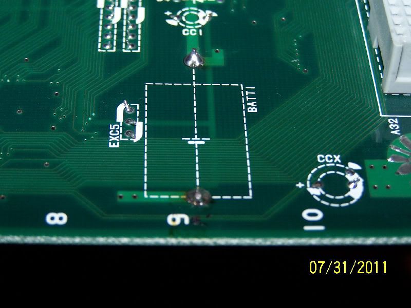

Only problem i've had is with burnt (black) rosin flux residue once i'm done. Not to hijack your thread but is the black burnt flux residue normal? should i buy a special cleaner to remove it?
I use Kester 951 No Clean Flux and normally clean up with some 70% isoprophyl alcohol. The alcohol doesn't take off the burnt flux tho (atleast i never scrubbed that hard), and i did some reading on the netz and many said it was normal and just to get some cleaner to take it off.
here's a pic showing what i'm talking about you can see some yellow/black from the flux by the number 9 and around the lower through hole solder joint.

Hello, no , no special cleaner, just rubbing alcohol...just after you solder use a brush(not wire) while its still hot. Its easier to clean that way!
IT SOUNDS LIKE YOUR USING TO MUCH FLUX. IT TAKES MINUTE AMOUNTS..IF YOU CAN SEE IT POOLED UP ON SOMETHING, OTHER THAN A VERY SMALL DROP,WIPE IT AND START AGAIN. YEAH I TOOK A LOOK. TO MUCH FLUX BEING USED.
thanks great info, last night when i replaced an Xtal it was strange the No Clean flux evaporated really quick and didn't leave the board wet at all, i normally only use 1 drop from my eyedrop bottle and that's all. I was thinking that it might be the solder i'm using as it's 60/40 rosin core light duty electronics solder from radio shack as some of the info on the burning of the flux said that could be the case. i did pick up some acid brushes from the local ace hardware the other day :D
Flux
Ok...if you apply flux and you have a flux core rosin, you are doulbling up !!!
Just keep in mind to clean while still hot!!! TRY USING A SN63 SOLDER...ALSO SOMETHING TO KNOW...SOLDER HAS THREE STAGES...THE MIDDLE STAGE BEING CALLED THE PLASTIC STATE..YOU MUST NOT MOVE COMPONENTS WHEN IN THIS STATE..WICH LAST ONLY A FEW SECONDS..SN63 HAS NO PLASTIC STATE..BETTER TO USE IF YOUR HAND IS NOT ROCK STEADY.LESS CHANCE OF BAD CONNECTION!!!!!!
