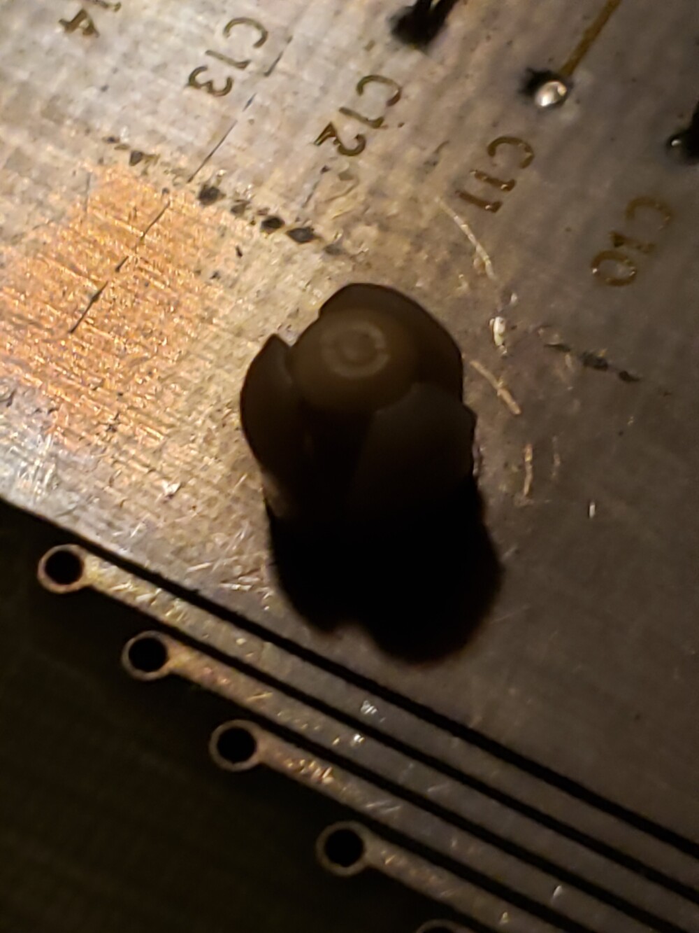

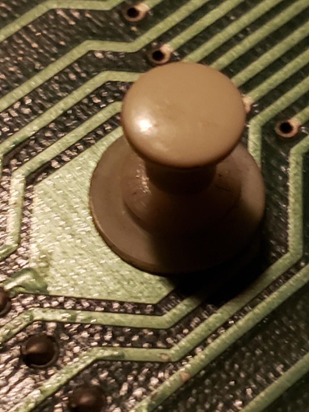

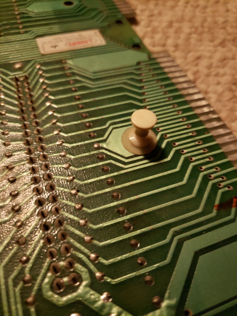

As described by the OP, these are the pins which attach an Atari filter PCB to a cage.
Since I've designed new C&D and I,Robot backplanes, I'm curious to see how well they fit together with a cage.
Here's some pics of the fasteners in an original filter board. These old pins tend to be hard and brittle so replacements would be a nice to have.
These originals also tend to be a pain in the @$$ to remove.
"Push-Lock Pin" ... might work.
The filter boards have a 6mm dia hole. Those Leviton might be for a 6mm or 8mm hole = not sure; though Q&A on Amazon implies a 1/4" hole compatibility which is good. :unsure:
Thanks.
EDIT: Just remembered I have some different push type pins which I purchased for my Sencore CR7000 (back flap had this missing).
Unfortunately, that particular pin is for a 8mm hole. So, too big for this 6mm application. :(
