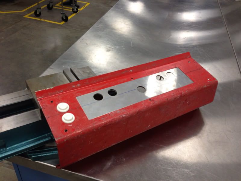

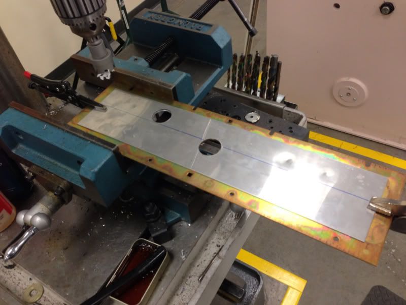

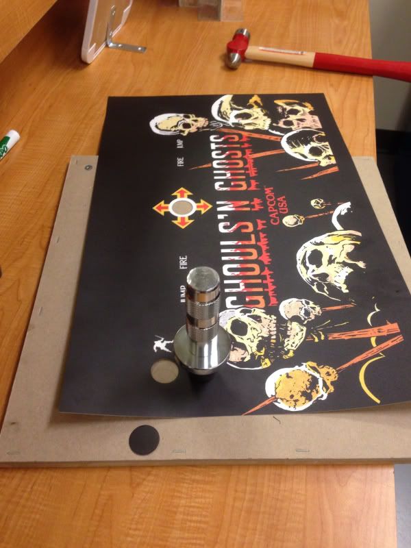

Here are the results. The Fabrication part is mine..
Work was a bit slow, So I decided to work on my Control Panel:
And the Final Product:
Again Thank you, & I hope people will use this method. It does work.

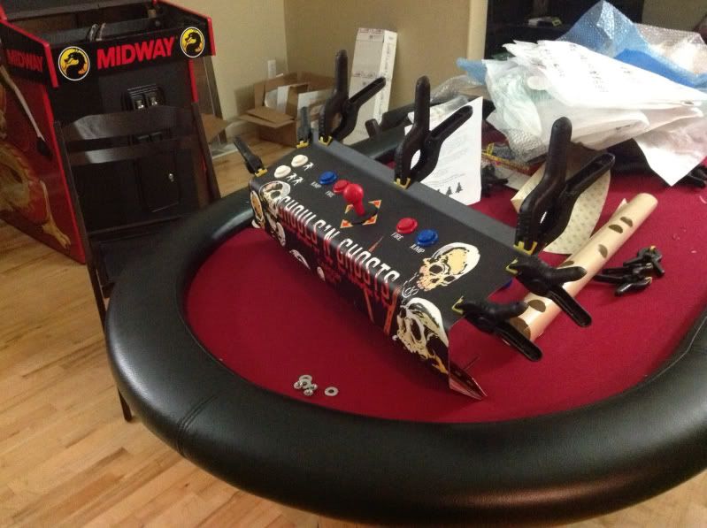

I'm surprised neither of you used felt pads or something else soft on the tips of your clamps.

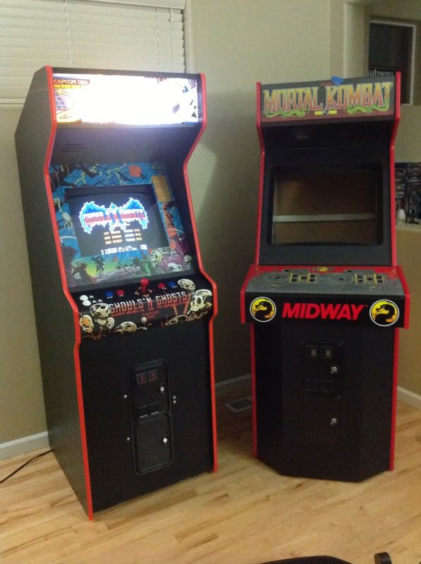

Great job, would love the have a G&G machine. It was one of my favorite series growing up besides SF, capcom was my world BITD. Do you happen to have a photo of your line up? Also how is that SF1 coming along?
Hey Challenger,
Thanks! And, sorry for the late reply. I wanted to wait till I was able to
capture this 1 picture. (Just picked this up off Craigslist today)
GnG & GnG:
As far as the Street Fighter, I've been neglecting it. (I play it, but letting it sit for the right time. I got too many Projects)
Here is a glimpse next to the Championship Sprint:

Well here it is, & I'm telling you it gets easier. Had this done in about 2 hours.
Here's a few shot. Again, the write up works.
Original Panel. Pretty beat up.
With the heat gun, makes life easier.
I used two buttons to lock down the CPO in place before peeling & applying the bottom half.
Locking it Down:
Final Result:
