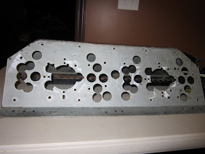

Lets start with the stripped CP and start getting it down to a clean Control panel.
Here's the pretty messed up control panel from an HS5 25" Monitor cab.
attachment.php
With the metal control panel completely stripped you can heat the back side and pry off the CPO. This will just leave the layer of adhesive stuck to the metal.
attachment.php
You can lift pretty much hole sides of the CPO if you work it right and not just small chuncks. Just tear/cut it at the corners or at sections where it begins to get too big to handle/pull (CPO material)
attachment.php
Heat and pry, heat and pry... rinse and repeat.
I try to pull strips down and just heat the area in front of where i'm pulling. Try not to get one spot too hot.
attachment.php

continued stripping it down.
You should be able to get all vinyl off of the control panel.
attachment.php
The next part is cleaning the adhesive off of the metal CP. You'll need to make sure that you are working the metal scrubbing pad so that it scrapes off the adhesive into little balls and it can fall out and kind of collect on your floor or work surface. Try not to step on these as it'll gum up your shoes.
I soak it down with brake cleaner and try to work fast as the stuff evaporates quickly. I also try to work in one direction cause as the pad gets gummed up you can just spread the adhesive right back onto the metal area you are working.
attachment.php
After maybe 20 mins, you should have most of it off. I also work down to finer steel wool and do a cleanup wipe with that or a paper towl. I go over it slowly and inspect it for left over areas that need cleaning. I also take the time to wire wheel rust and old paint. The corner cuts are areas that are typically rusted that need to be stripped.
attachment.php
After a while you should have a pretty clean control panel. I wire wheel any rusted spots to expose the metal. I seal that with primer where I can. Under the CPO it will rust and the rust will cause lifting under the CPO.
attachment.php
