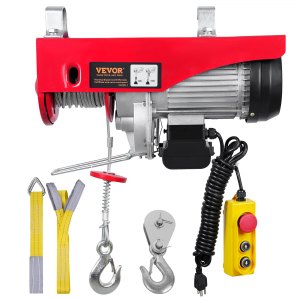

I have an electric hoist that I bought to help lift 4x9 hardie panel siding to install on the 2nd story of my house last summer. It was a huge help. I'm considering mounting it above the doorway to my basement stairs to help raise and lower cabinets/pins. I'm scared it could rip up the walls pretty quickly though if I can't control the load as it moves.
