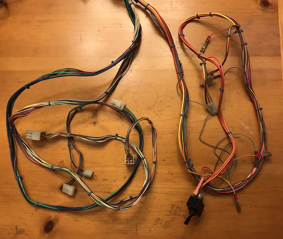

Complete (I think?) Thief Harness....
....Posting a few pics here for future reference ;)
Appears that the power supply end has had connectors repaired/replaced, might need to find additional pics of one installed for reference:
Looks like splits off into (2) other harnesses all zip tied together (right side in this pic looks like mostly PCB connections):
Left side looks like monitor, control panel, other (tape deck/marquee)? Right side maybe coin door related and on/off switch:

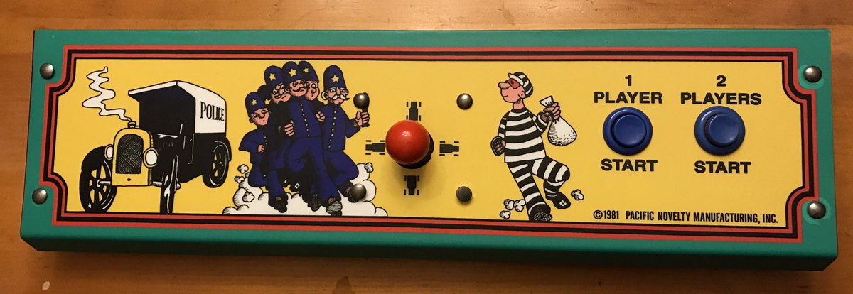

Control panel:
Not sure if production was like this or done later, but wires are all soldered to the mating leaf springs. I will keep all in tact, just pull leafs with them to send for repro:
I'm looking forward to seeing these repro'd - thanks to Golden Age Arcade Parts! :)
-GackAttack
