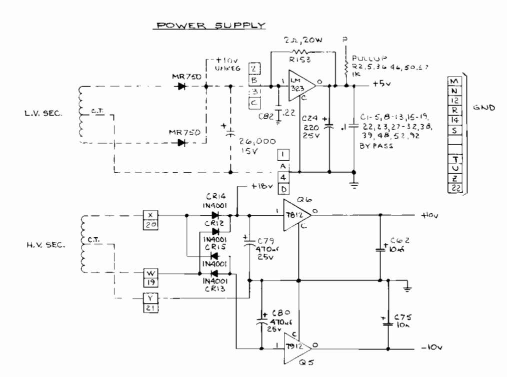

OBSERVATION: Ah, that large power resistor in parallel with the LM323. 2ohm 20W. There's some good Arcade Classic Repair vids on this circuit. The resistor is there to help regulation and startup inrush. But I believe if there is a regulation issue, the LM323 should be doing alot of the work (regulating voltage and passing current) under normal conditions. (Though if you work thru Ohms Law and assume the input is 12V (10Vunreg), the output is 5V and the current is 2amps, then the regulator has an impedance of 3.5ohms and it and the resistor are sharing the load current and both are getting hot, but the regulator is less hot than if the resistor was absent from the circuit. This being said it is possible for the 5V circuit to operate at higher current than the rating of the LM323 since some of the load current is supplied by the parallel 20W resistor). Perhaps excessive power issue is occurring if either the resistor is out of spec AND/OR the LM323 is faulty. "Power and Connections"

Power resistor measures 2 Ohm in circuit, and smoked a little bit the first time I had the power brick plugged in to everything. Smoke never came back enough to see when I had a camera on it.
Also, I was dumb at some point and killed the original LM323 by reversing voltage going into it (was confused by readings I was getting and thought my wires were backward in the connector, they weren't.)
Currently have a new LM323 installed from APAR that the fuse issue persists with.
Yes, the power resistor, at startup, is managing the inrush current into the logic board's 5V load. It will have a spike of power (and perhaps "smoke" for a second) and then it and the LM323 will share the load theoretically well within their specifications.
Reversing the input voltage might have damaged more than the LM323 as the 20W low-ohm resistor is still in circuit. Thus,, the load side will see the inverted voltage. :(
I am pretty concerned about this too, so will be checking C24 and any other electrolytics closely.
More importantly, for a simple linear regulator the input current will only be slightly higher than the output current.
Conversely, if the input to the regulator is fused at 2amps, then one surmises that the output current will be less than 2amps.
If only powering the +5V rail, this can be confirmed.
But when reviewing the schematic, the 10V unreg rail is also used by other components directly. So any fused 10V unreg rail will have even more amperage than that alone for the +5V rail.

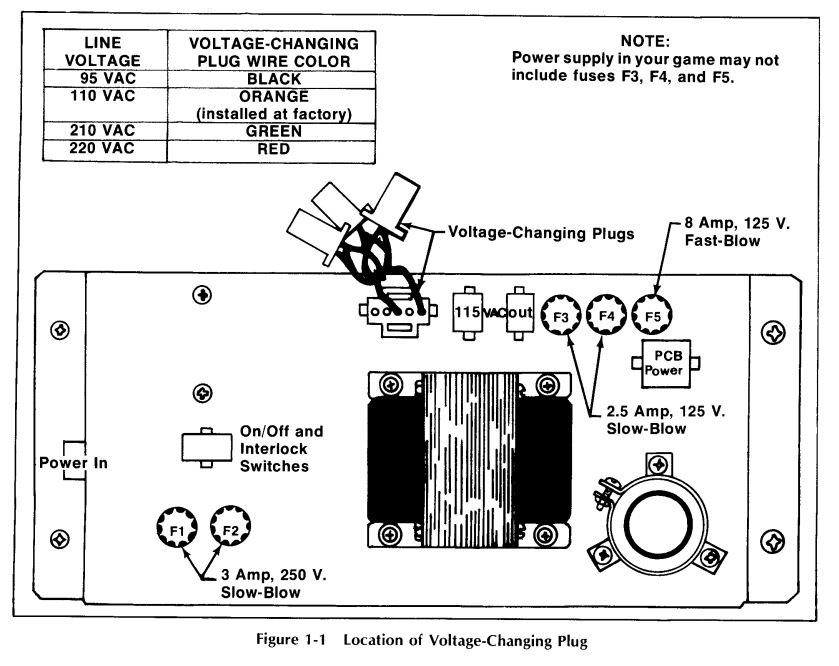

EDIT: The 2A fuses are on the AC input side and not the 10VDC unreg output.
Just saw this edit,
The manual only refers to 4 fuses total, two on power brick, two on monitor. My power brick has 5 total, the two it mentions in the manual, then 3 more spots which are fused as follows (looking from the top, left to right): 25A, 2A, 2A
Can't find mention of these three fuses in the schematics, and the fact one of them is 25A seems a bit silly. Here's where I think they exist in the circuit:
Pretty sure my fuse that's popping is on 10V unregulated just after the MR750's because I lose 5V on the game when it happens. It measured near 12VDC last time I checked with the connector unplugged. No significant AC voltage detected there.
It's the last 2A here that is for 10V unreg that we've been discussing. Red wire, green stripe:
So, the power brick does not match the Starship manual.
What to do? ANSWER: research other games around the same vintage that use that brick and have similar functionality.
OBSERVATION: Canyon Bomber (1977) uses that brick with five fuses. The fuse in question is noted to be 8AMP 125V FAST BLOW.
So, we must ask the question -> why are you using a 2AMP slow blow in that location, assuming that fuse location is wired the same.
The use of an 8AMP would make more sense for the 10Vunreg rail, no?

For a linear power circuit as we have here, the amperage on the +5V output is the same (more or less) as the input current off of the +10Vunreg (neglecting the other circuitry off of this rail). So, fusing typically is defined at 150%-200% of nominal. This confirms that the 10Vunreg fuse should be in the 8A range.
So we conclude the following,
1. wrong fuse value being used (at F5)
2. logic board is faulty but not the cause of the fuse opening
3. the observed 3.6A off of the +5V is consistent with other Atari boards
