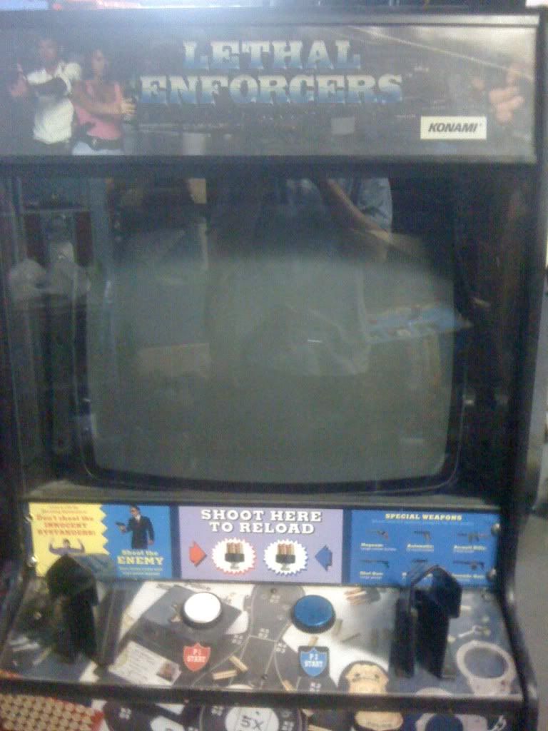

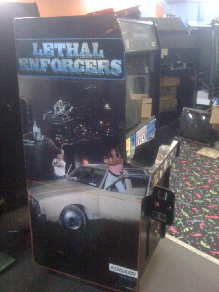

was out doing another warehouse raid today and came across a mario bro's wide body converted to a lethal enforcers
when i got up close i was amazed someone crammed a 25 inch monitor in it
at that point i didnt care what it cost i had to have it
going to strip off all the lethal enforcers crap repaint it and install a 19 in 1 multi board for some sweet 25 inch mario bro's goodness lol
i think all the wide body games should have been like that from the factory its pretty impressive having the 25 inch monitor in the mario cab
yea it was not a bad conversion they def spent some time applying the art its puzzled togather in like 6 diffrent sections (making it a pia to remove lol)
i wish they would have drilled and mounted the guns on the cp and not the front of the cab tho because otherwise the cab itself does not need any bondo work
but alas since there is 2 big holes from the guns in the fron ill have to bite it and bust out the bondo argggg
lol pluss the fact that a standard nintendo cab r-type pc10 has a inner di of just over 22 1/4
(just measured a dk3 and a pc 10 lol thats the nice thing about having over 100 games at my finger tips )
and the shelf mount 25 inch zenith k7000 thats shoved in it has a frame width of 25 1/2
The CP is different and it looks like the cab was altered to accomidate it. It should have a speaker right in the middle with space to house it.
I agree with this. If it was a Mario widebody, then they not only chopped off the panel under the CP and filled in the speaker grill holes, but they cut the side profiles of the cabinet as well.
I certainly didn't mean to ruffle anybody's feathers. :) I own a Mario Bros. widebody, and play it every day. I know it well after vectorizing the cabinet and building a few cabaret versions of it. That cabinet looks sigificantly different than mine. I guess that heavily modded front and different side profile seriously threw me off.
