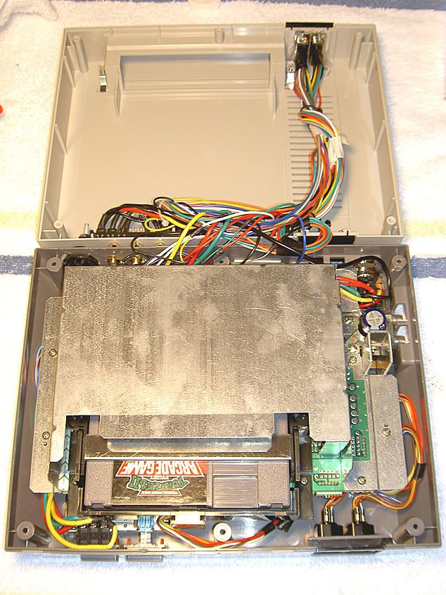

Hello ladies and gents,
Well, after long last, my 1st ever Supergun is now complete. I call this project "Ultimate NES". My goal for this project was to have a system that could play games from my favorite console of all time, NES, as well as JAMMA Arcade games and Neo-Geo MVS games. I have now reached that goal :)
Specifications
Enclosure: 1985 Nintendo Entertainment System/W New 72 Pin Connector
Power Supply: Astrodyne External Triple Output, 5V@10amps, 12V@3amps, -5V@1amp
Outputs: Composite Video, S-Video, Component Video, Stereo/Mono Audio
Inputs: JAMMA Connector and Neo-Geo Controllers
Video Encoder: NeoBitz + JROK Sync Cleaner
Weight: 3lb 8oz

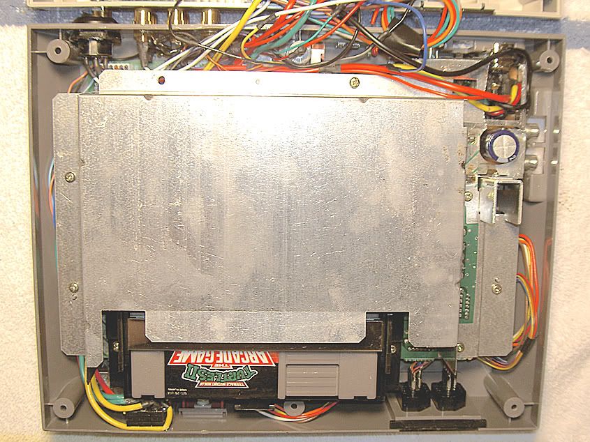

Looking at this unit from the front it looks like your average NES and that is one thing that I wanted to maintain. The NES motherboard has not been modified and functions as original. The NES system and the Arcade circuits are powered on by the push of the NES power button, which engages the 3 Arcade momentary switches and the NES power. The NES motherboard is using the 12V@3 amp line for power. NES and arcade games can be played at the same time ethier on two different TVs or you can hook it up on different inputs on a VCR and switch between NES and Arcade by remote. I love being able to switch between the NES TMNT Arcade game and the actual TMNT Arcade game. Yes, I am a major TMNT nut
It was a tight fit, but I am really glad I was able to fit all of the Arcade components in with the NES motherboard. I have thoroughly enjoyed putting this project together and I really enjoy being able to play all my favorite games from my childhood on one console.
The Ultimate NES - Now you're REALLY Playing with Power!
Sorry, I couldn't resist
I hope you enjoy the pics and info

Okay, now that is slick, well done. I especially like the flip-up bit for the Neo controllers.
Do you have a secondary piece that you're using for whatever pcb you're currently using, or does it just sit off to the side somewhere?

Looks to me like the JAMMA PCB plugs straight in the back. Unless he has a extension cable that isn't shown in the pic.
Nice work. I couldn't see doing that to a toaster NES myself, but then again the top-loaders wouldn't have room for all that stuff.

Thanks guys,
Yea, I have an about 2ft JAMMA extension harness that plugs in the back. I have a TV stand that has a shelf with two levels and what I do is lay the PCB on the bottom shelf and the NES on the top. I then just bring the extension harness down the back of my stand to the second level and hook it up to the PCB. It actually works really well ;)
