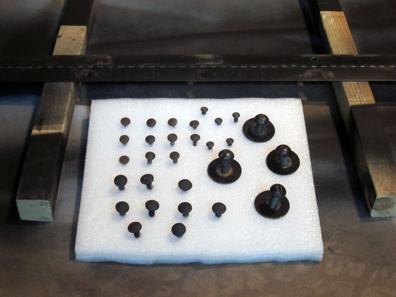

I painted the hinge and bolts flat black (some of these go to another game). The square part of the old carriage bolts didn't fit through the holes in the CP, so the bolts stick out a tiny bit in front. I'll probably just let it be, but I could just use a slightly smaller carriage bolt.

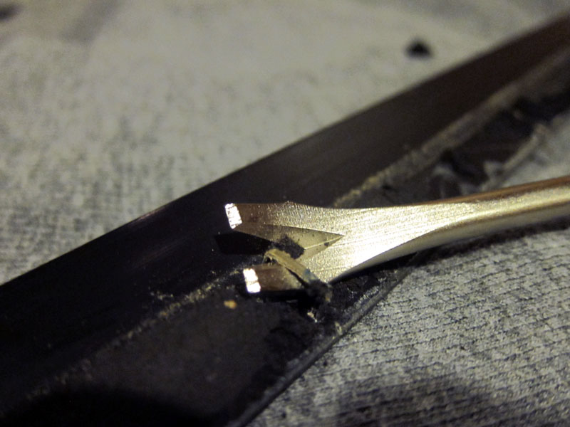

I made more progress on my CP today. It took me about 30 minutes to grind down the shoulders of my leaf buttons so they'd fit. I used this Dremel bit:

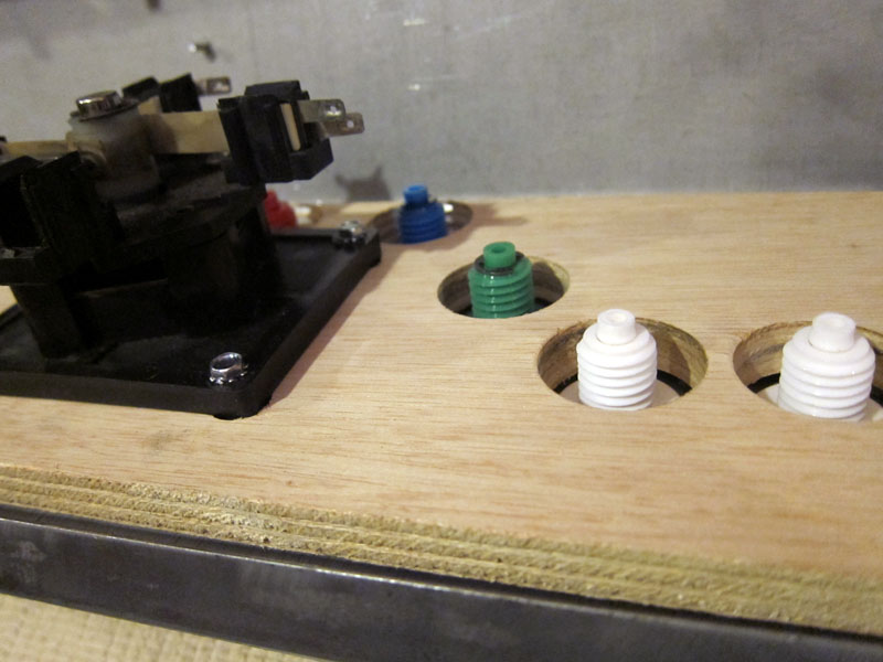

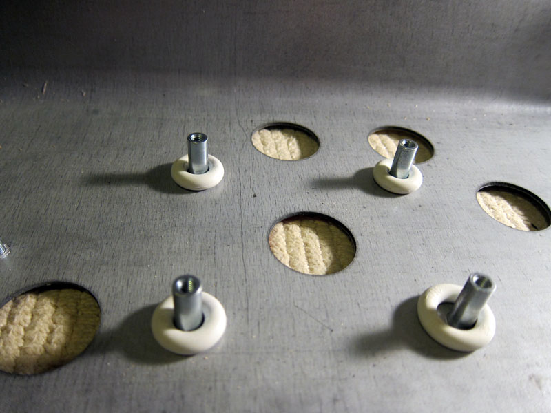

I wanted to be able to screw leaf switches into wood, so I riffed on Prairied1ll0's idea. I made a paper template and drilled out a 22"x5-1/2" piece of wood, 1/2" thick. I used a 1/2" spade bit for the joystick lugs, a 1-1/4" hole saw for the buttons, and a 2" hole saw for the joystick itself. Pictures are better than words here:
The small rubbers were great; they hold the wood tight once the WICO joysticks are installed, and they leave just the right amount of room to install the dust cover under the CP:
I checked the clearance with a leaf switch I pulled from my Joust CP, and it was perfect. Unfortunately I forgot to order leaf switches to go with these buttons, so I won't be able to finish this today.
There is one problem with the panel I made: the holes are too large to hold the PAL nuts. Fortunately the buttons are so tight they don't budge anyway, so this was a non-issue. If I did this again I'd drill a smaller hole, and just use a Forstner bit to cut a shallow hole to clear the button shoulders.

Forstner bits are the only way to go when drilling old wood cp's.
The spade bits really chew up the old plywood cp wood.

The leaf switches with the taller standoffs worked perfectly, so I didn't need the wood after all. I did keep the 2 blocks in place (copying Prairied's idea):
